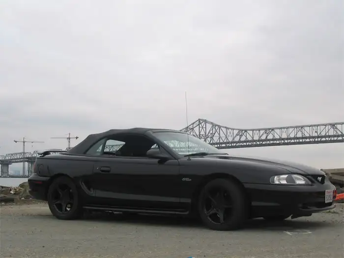

It's like looking in a mirror except I got the chrome cobra looking rims. Your car looks GREAT!!! Thats what I want mine to look like. How is the handling and is the ground clearance pretty good as far as speed bumps, driveways, etc.? How much did it actually lower the front and rear? Did I say it looks good?!

I have the H&R race springs...very stiff, but love the way the car handles. I wouldn't want my car any lower then it is, I already have a scraping problem. I heard somewhere that the optimal drop for a mustang is 1 inch lower then stock.
All those cars look good. So technically the race springs don't lower it as much as the SS springs, right? Just curious as to how much an 03 GT will be lowered with race springs. Thanks.
