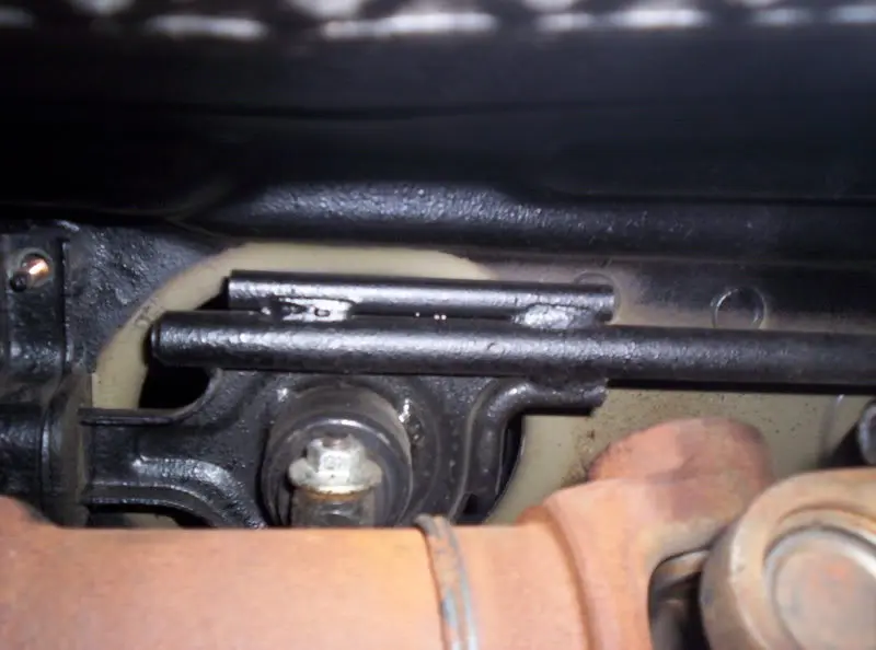

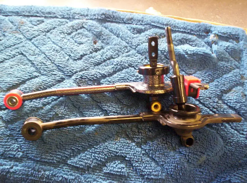

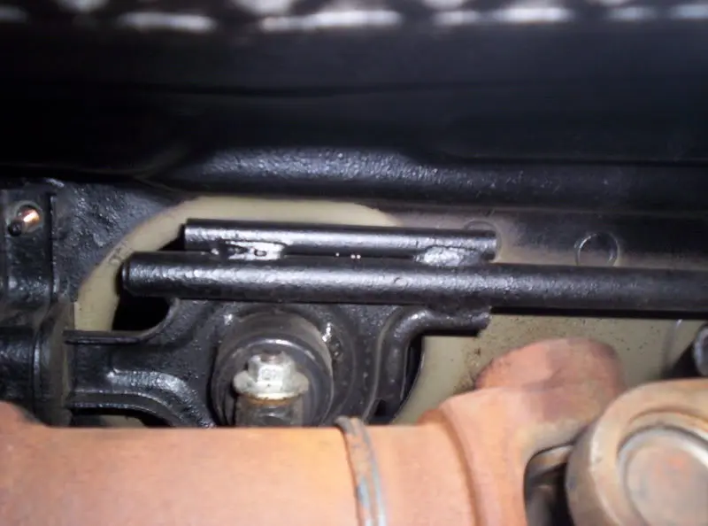

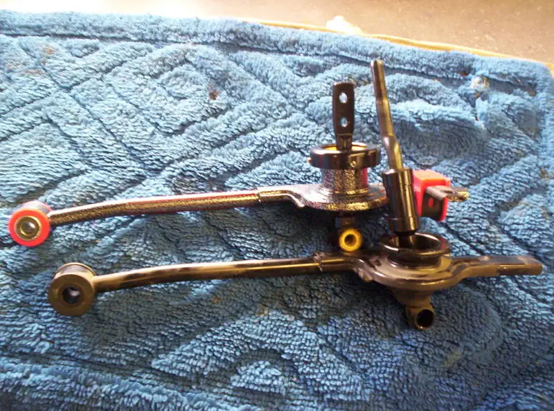

do these pics look like your set-up?
did you install both plastic bushings at the bottom of the shifter? did you put locktite on the nut for the linkage? check all 4 fasteners to make sure they are tight.
this write up may be of some help... http://www.stangnet.com/Tech-Articles/S197-HURST-Short-Throw-Shifter-Install-061016.html
let me know if any of this helps or not.
