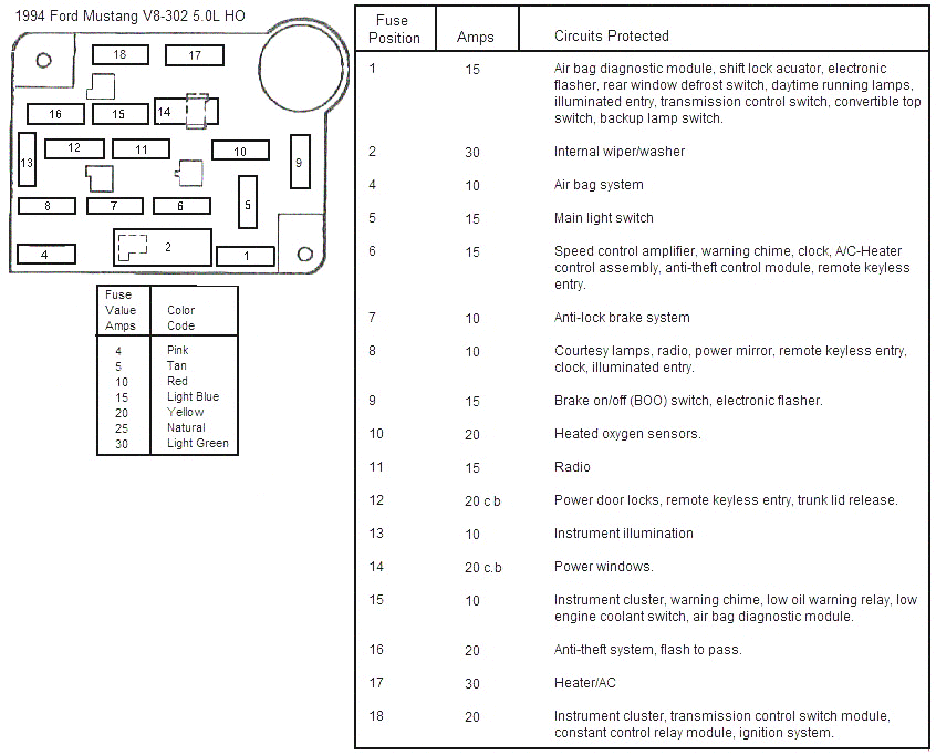

Check fuse 13 under the dash.
the controls work, the dash is fine.
Just the two bulbs behind the HVAC plate are not comming on.
17, 13, or 6 all have something to do with that area, I will check them all.
Worst case I'll tear it appart and try the old bulbs, one of them was still working.
Thank you for the diagram!
