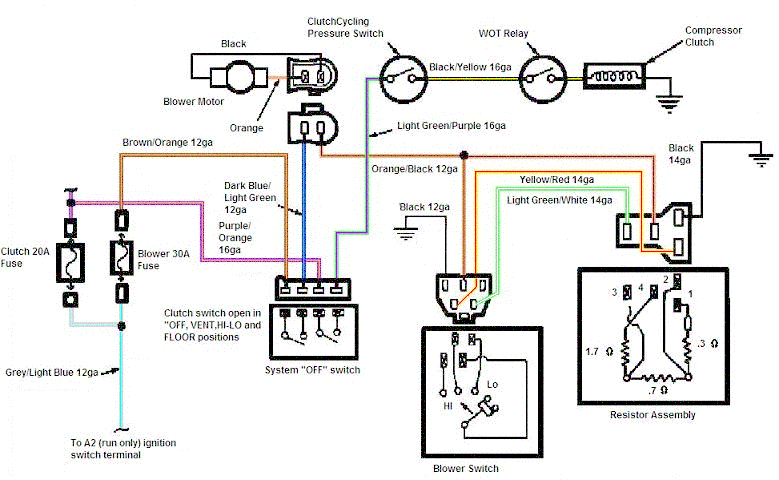

My blower doesn't come on at all. I took it apart, and tried chasing the wires down using this diagram:

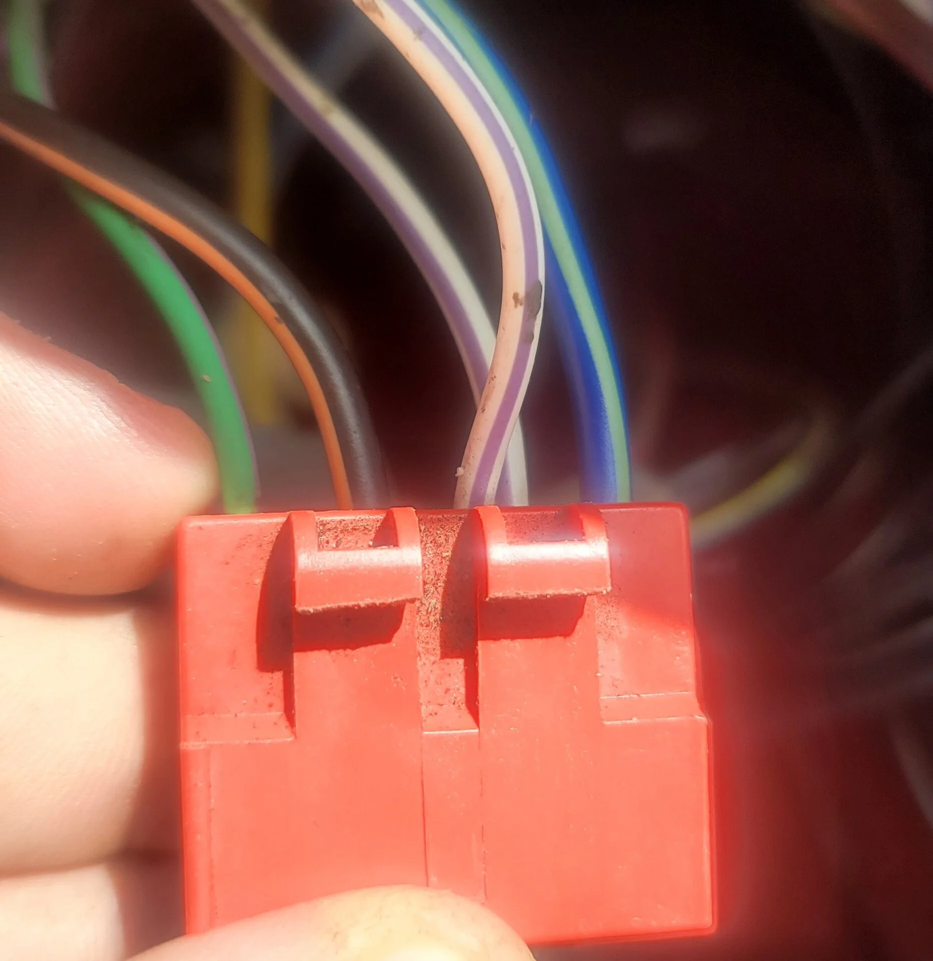

This is what the current wiring looks like, which doesn't seem to line up with the above, but I don't recall the wires becoming displaced when I removed the HVAC control panel:
Which is the correct configuration, and also, does anyone know where I can get a replacement connector? that seems to be the one that is a mystery even to google.

PM me your email address and I will send you a complete Ford Factory 89 Mustang electrical diagram set. The zip file is 2.5 MB and is too big to fit through Stangnet's email gateway.
The plug shapes on the diagrams match the plug shapes on the actual plug. The diagram is divided up by the layout of the car. The first diagram is for the very front of the car, and it works its way to the rear of the car page by page.
