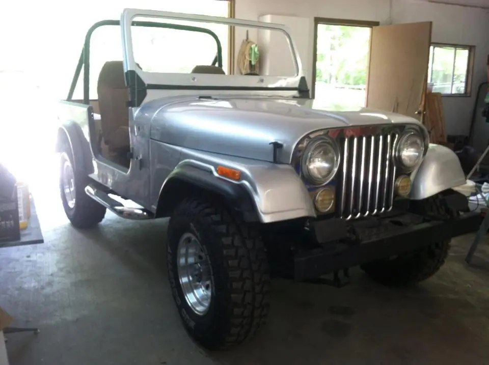

I'm stuck right now. I have parts to adapt a Ford T 19 to a Dana 20 Transfer Case ( wonder if transfer case has ever been typed on here before)....I'll try to keep this as "Pony" as I can. For the record, I do have appropriate supplemental badges on my CJ. As stated, (I believe) the 71 302CI from a 71 Mustang is top notch. The HP / High Nickel designation proved out during rebuild. Almost 50 year old block and only required a ridge reamer in the Cylinders. Went back with Standard Rings and she runs great. .... Ah yes, the tranny.....Original Tranny is a T 150 3 Speed. It needs attention so I thought it was a good time to get that other gear hole and go to a 4 speed. I casually asked if anyone knew where I could find a T 18 at church one Sunday morning. One of the Deacons said he had 2....he said I could have them..one just rebuilt. So the price was right. It ended up being a T 19 (all forwards have synchros on a T 19 as opposed to just 2,3,4 on a T-18)...The other transmision turned out to be a NP 435,...either would fit. I decided on the T 19 and ordered kit from Novak Adapters. I'm 57, so I decided I was old enough and had enough years behind a wrench to tackle the adapter. It is intimidating. I've also been spending some time on converting my mechanical clutch assembly to a Hydraulic system therefore eliminating the weakest link in my build, the spring, linkage, bell crank etc.... I am excited about the possibilities. Novak has a hydraulic throw out bearing that is adjustable. Unfortunately they are for Mopar or GM applications. But I am confident there is one on the market that will work and I shall find it. Meanwhile back on the farm.... I must continue my disassembly of the T 19, Drill and Tap out one new hole so adapter will bolt on..(Yikes..not crazy about that.)... I have attached a pic of my "Classic Half Breed" for your viewing. Felt like I needed to bolster my credibility on the Mustang Powered CJ. It's not a mall crawler, though it does turn a lot of heads, especially when I crank it or pull into the C-Store and Idle up to the pump. It's then that I put a smile on the "over 50" crowd as they recognize the slightly imperfect rhythm of an old school, carbureted, cam thumping 302. More to follow. P.S. If at anytime you find the content of my post not lining up with the normal storylines of the site, or you feel it ventures to far away from your focus, just let me know and I will take the next exit...Thanks, Greywolf.
