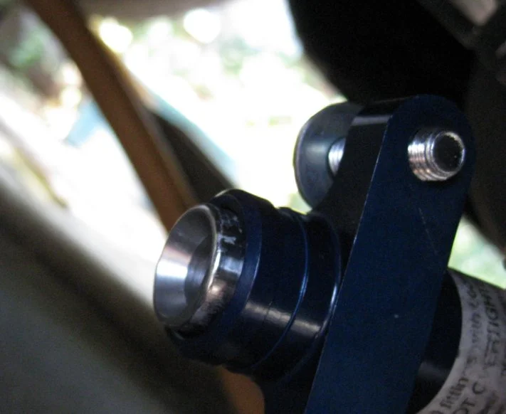

Jokes aside, I have nearly the same setup. I used the cnc master and an s10 reservoir.
My question is, when you bled the system, how far did the actual cylinder in the slave go. Was it past the threshold of the case or just flush with the beveling.
Mine was flush with the beveling in the case.
I would love to know, before I pull the system for a bench bleed. Time is short these days and the car doesn't like to go into reverse. I'm not sure if the problem is inadequate preload or air in the system.
