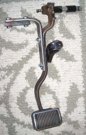

Failure 2 concerns the clutch pedal, and my question to you guys. Does anyone make the bushing thing that goes inside the tube that the pedal arm turns on?
You can see my solution in this picture from back in 03 when I first rigged up the clutch pedal.
I'm figuring on going this afternoon to look for more of those bushings. Hopefully I'll find some that are a better outer and inner diameter fit for my pedal. Course the tube that the arm's in is not standard. You can see more of my setup here.

I did switch out the cutoff push rod and square tube that it simply made a friction connection in for a spherical rod end. And that led me to find the problem with the way my pedal is mounted in the pedal assembly. The arc that the pedal has to travel in with that rod end attached forces it to wobble in the shaft, and it binds as it gets close to the floor. I guess that didn't matter when the end of the pushrod was free to move around.
