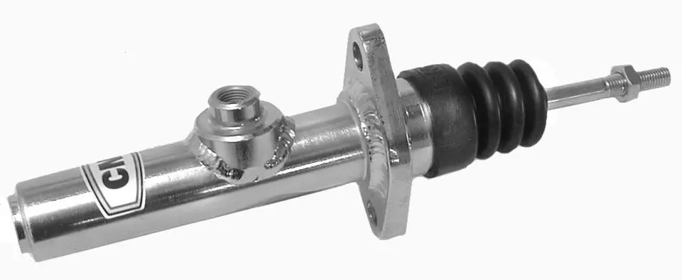

The only bolt in kits I've seen are the JMC ones. But a bit pricey. They use a CNC master that they've modified to fit the Mustang. I basicaly bought the CNC pieces and modified the master myself. Saved some money and it was a fun project
You want the Master cylinder to be on a bit of an angle so the rod pushes straight.

Thanks, the bracket is cut from 3/8 aluminum.
The master comes with the bracket going up and down
(sorry about the size of the pic:D )
I lathed off the old bracket, made a new one and then brazed it onto the master cylinder sideways so it would fit into the stock location. I also put the master on with a bit of a downward slope so the pushrod is a straight push.
