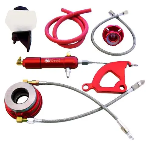

i’m going to. i too am using a CD 009, but behind a 2jz. I plan on using a T56 hydraulic T/O bearing, but haven’t gotten to the pedal part. mccleod sells a kit to keep the stock mustang pedal/quadrant that pulls on a hydraulic slave cylinder that passes through the firewall, and pushes the fluid to the bearing from there.
