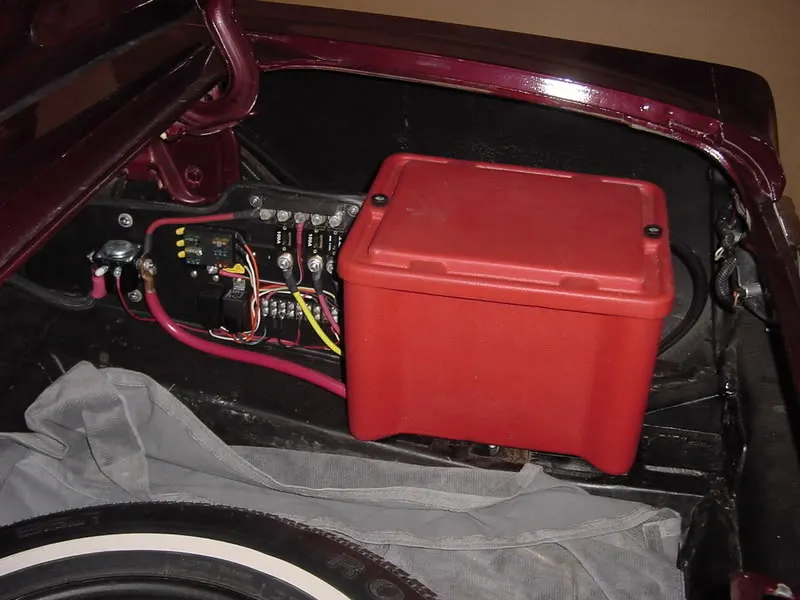

Here is a pic of the power distribution panel I made when I moved my battery:

I am in the process of trying to move the battery to the trunk of my '69 and ran across a picture of your set up. It looks awesome! And exactly how I would like to wire a set up in my project. I have read several posts, but am still confused as to the safest way to do a set up like yours. Could I bother you to send me a picture of your set up labeled so I could reproduce it in my project. I have the stock starter and Powermaster single wire alt. I have just ended up with a giant headache trying to filter through how to wire a set up like yours, although I was wondering if you have any breakers wired in for safety? Any help would be greatly appreciated!
