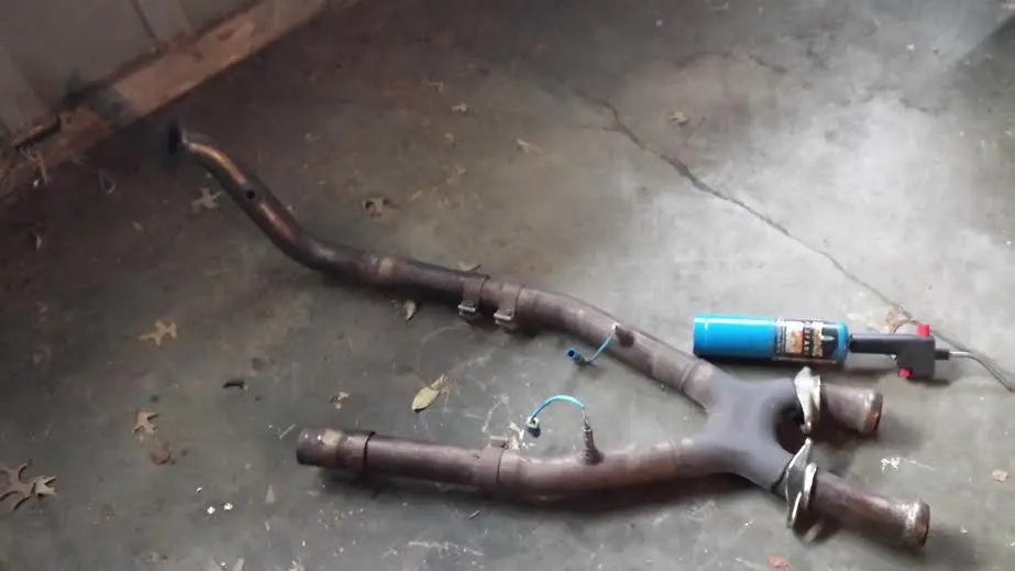

I have removed everything in the way including the stock manifolds, oem exhaust studs, starter, and steering shaft. Some of the exhaust studs came out with the nuts, some did not. I used pb blaster, a torch, and a dead blow hammer to separate the front section of a bassani stainless modular x pipe that has been contently existing without antiseize for the last 6 years.

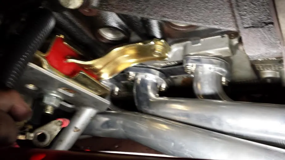

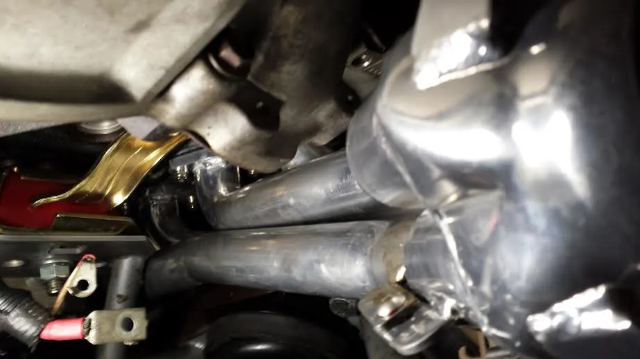

I won't swear to it but this will likely be the only modular set of headers I ever install. Anyhow here's some progress pics. Got the right side on. Hope its the harder of the two sides. Going to get some new front O2 sensors while I'm in there. I am a little concerned about contact in a couple of areas but we will see how it goes.

Now I am wrestling with the mid pipe. I had it installed to the collectors but when I went back to hook up the tail pipes, the mid pipe was too far back to meet the catback. I could not bend, force forward, or finesse the damn things together. Mid pipe is about and inch maybe and 1.5" too far back. The same freaking pipe worked fine before, only thing changed is the front pipes that connect the midpipe to the collector. Now I must figure out why this is.
I know it can be the headers and. The collectors slid on and I drove them the rest of the way with a board and a drilling hammer. I haven't changed anything about the stock catback. It has to be somewhere in the new connections between the cat delete pipes and the collectors.

Another update. After numerous times torquing and checking for leaks, I have so far been unable to correct the right front primary's leak. A little digging today yielded a new discovery. There is a contact issue with the UPR k-member. The mounting plate for the passenger side motor mount is not allowing the front primary to line up correctly. :chin
I removed the individual primary from the collector and used a dremel and file to take some of the material out of the mounting plate. I shot the bare metal with Rustoleum and am now waiting for it to dry. Hopefully, once its back together everything will line up. Fingers crossed.

2) Despite what a few internet sources have said, Bassani Mid Lengths will work with a UPR tubular K member. However, I did have to clearance the top of the motor mounting plate on the passenger side.
