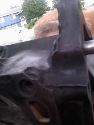

I bought a used block, it looks like a corner is broke off.. is that ok?

I bought a used block last weekend, and I had my brother pick it up. I was examining it last night and found that a corner of it is broken off... Is this going to pose a problem?

It doesn't look broken off to me. :shrug: The raised edges you see are parting lines from the mold they use when they cast the blocks. Just look around at other areas of the block, I'm pretty sure it's ok. One way to check for actual cracks is to have the block Magnafluxed by a machine shop. Good luck!
