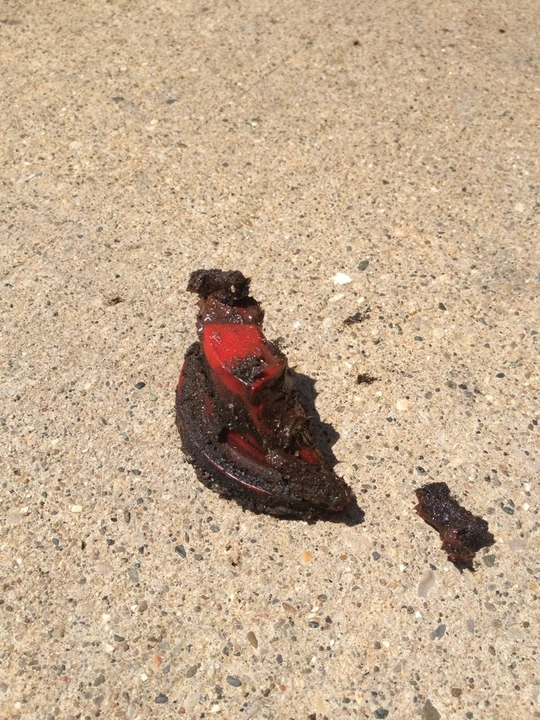

Took the Mustang to this car show today. On the way home I ran through the gears and while going from 2nd to 3rd I heard a noise from the rear of the car. Now when I hit a bump in the road, the rear end feels like its floating or shifting over. Kinda hard to explain. I did a quick look over the under of the car and didnt see anything broken.
The car has NT555R tires in the rear. MM LCAs, FRPP B springs and thats it for the rear. Stock 100k mile shocks and quad shocks.
What could it be? I was thinking either the UCAs or the bushings in the UCAs.
So heres what was causing the problem. Thats the LCA insert on the chassis side. I have the MM ones too.. I ordered new bushings from them yesterday. Ill install them and see how long they can take the abuse.

Yep their heavy duty LCAs. They had been installed since 2009 or 2010. I think their undoing was extra power from the blower and drag radials. I had no problems while I was NA.
They sell an extreme duty arm that has spherical bushings on both ends. I may go with those eventually.

Finished up installing the new bushings and new KYB shocks and struts and what a difference it made! The car feels young again.
The passenger bushing had a good chunk missing and all three pieces were torn so I believe the pin inside the bushing moved around in it causing the swaying feel. The drivers side was also torn all the way through.
