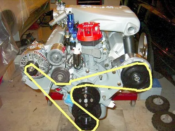

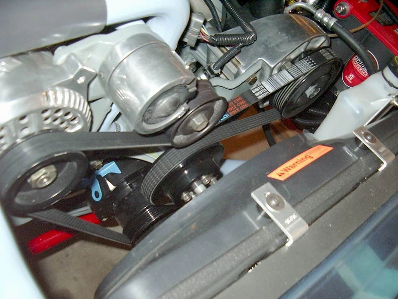

This all you need to do....
Check to make sure you have the correct AC delete bracket for the PS pump.
Remove your smog pump.
Route your belt like in my pic below.
This WILL work, but depending on what size pulleys you have, you will have to make a few trips to the parts store and try a few different belt sizes until you find the size that fits best. Here is what mine looks like installed... LOTS of room between the tensioner and water pump pulleys. Good luck.
