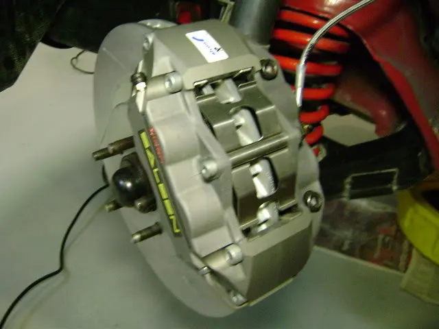

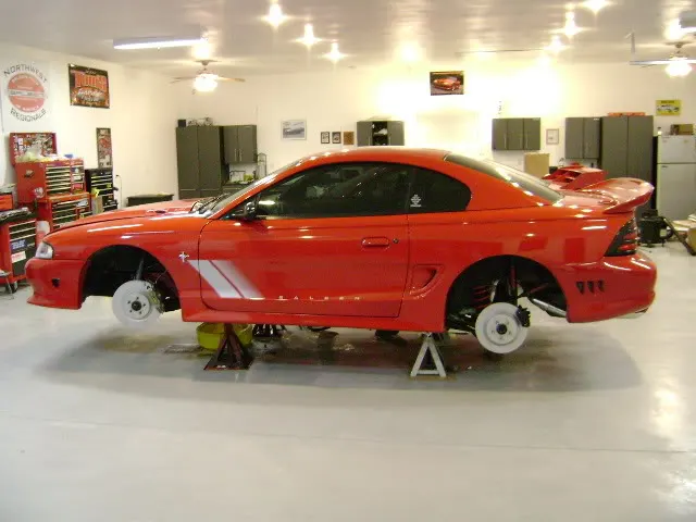

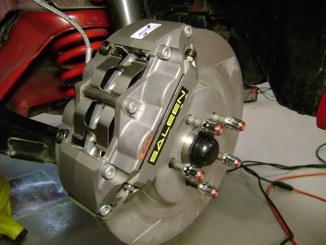

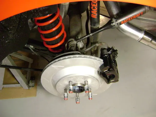

I just got 14" Alcons on S351 #58 with 13" rear vented Alcon rotors.:nice:
The 14" Rotors really fill up a 18" wheel!! The car was just dropped down here so it's sitting kinda high still.

Thanks!! I was going to go with a 6 piston but have 4 piston Alcons on my other Saleen and know how well they work and I got a smokin deal. The calipers are the same size just 4 bigger pistons instead of 6 smaller. The calipers are Huge compared to a Cobra caliper.
MM&FF did a test using only the front Alcon 14" they didn't install the 13" rear rotors because they wanted to be able to bolt on 15" rims with slicks. You can see how bad after the 3rd test the stock brakes get in the Cobra...not something I would want on a road course, I can see why you say people would loose it with stock brakes in their Vettes.
They had a 97 Cobra and the front rotors were Baer 2 piece this is what they found with just the Front 14" Alcon installed. No fade at all.
100-0 1st- 389ft 2nd-444ft 3rd-464ft , COBRA
80-0..........250ft.......304 ft......320ft
60-0..........140ft.......191ft........211ft
100-0 1st-370ft 2nd- 372ft 3rd-376ft , ALCON
80-0........229ft.........235ft.......238ft
60-0........120ft.........132ft.......134ft
