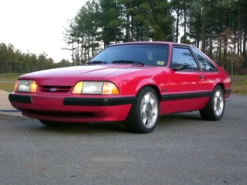

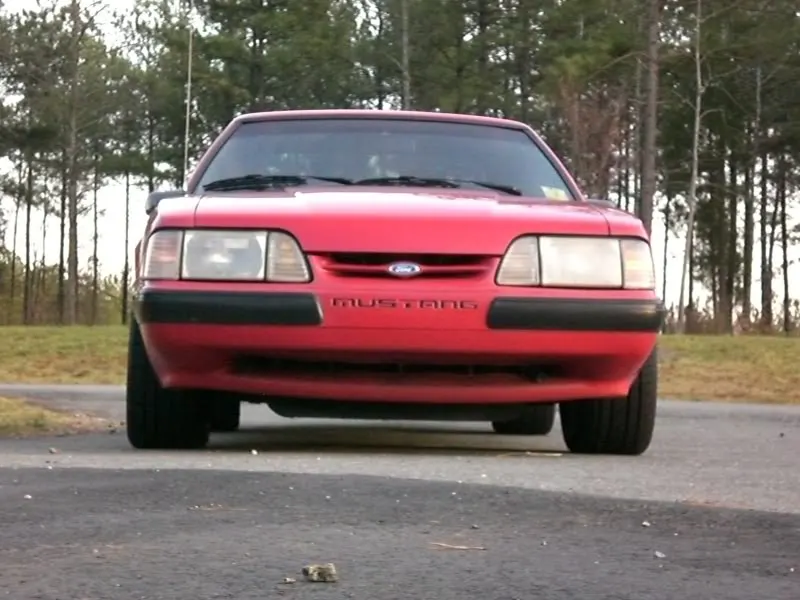

I have run 245's on my 17x9's and have never had an issue. Its a great fit. Have the 275's on the rear and no fitment issues. No need to beat my fenders out. Car is also lowered, see THIS THREAD on pics and info on mine.

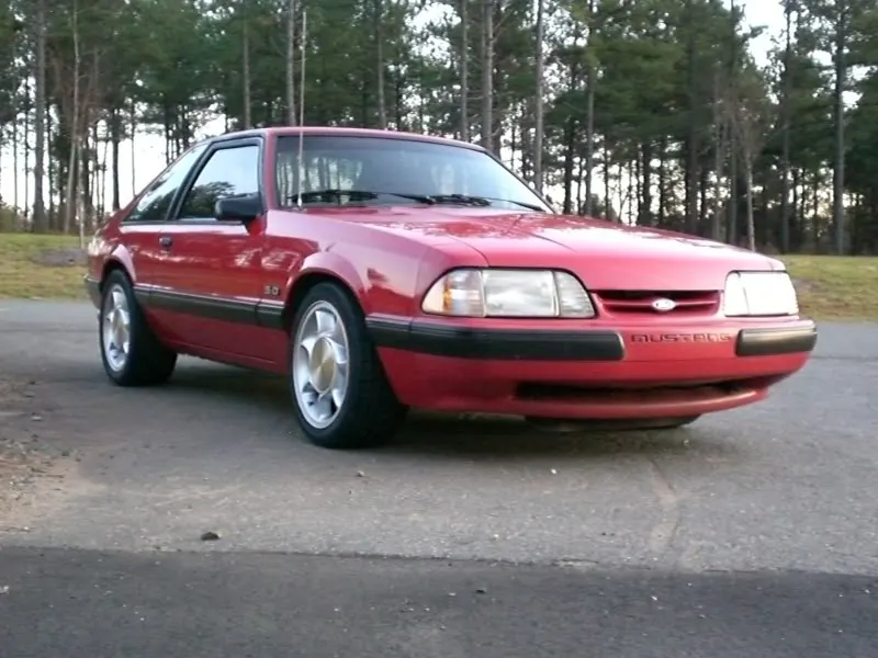

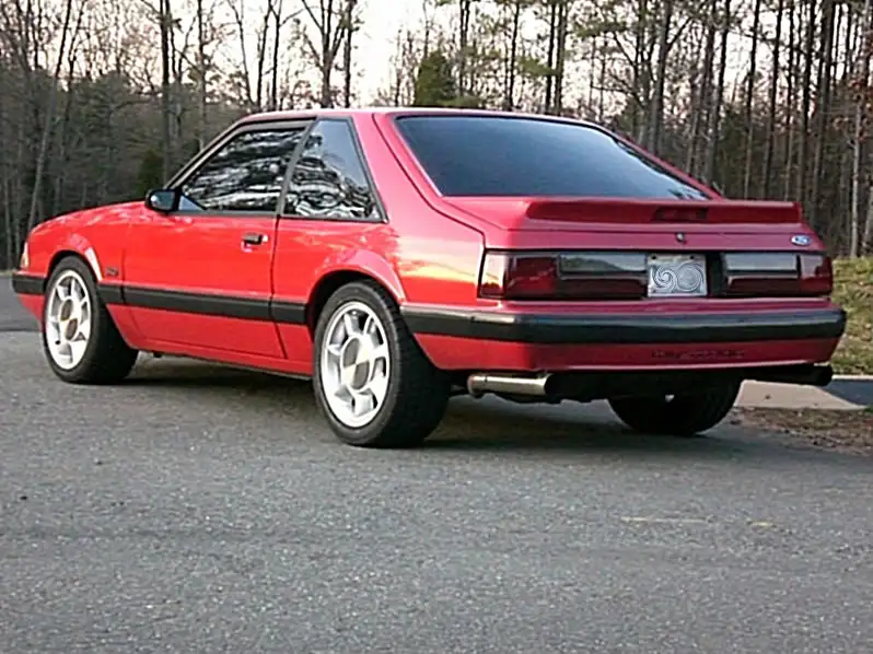

mine are 245/45 front with 275/40 rear. makes the fronts and rears closer height wise.

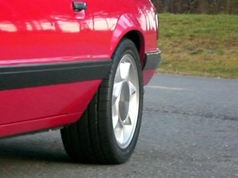

however, when i get around to putting new tires on mine im doing 255's up front, full-lock wheel rub be damned. the 245's just look too narrow on the 9" rim. ive got about 3/16-1/4" of rim lip that sticks out past the tire. the 275's look just right though.

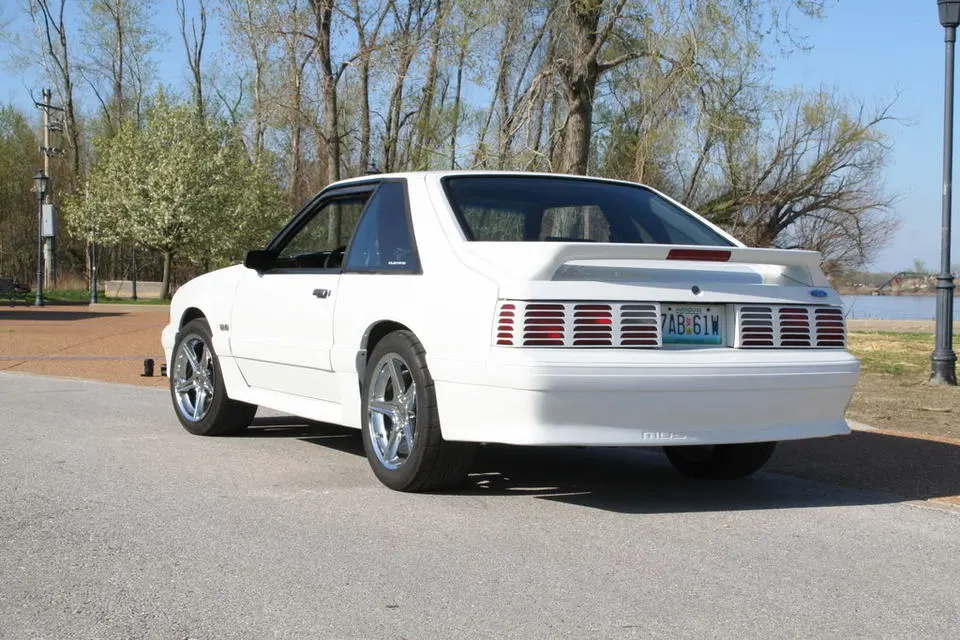

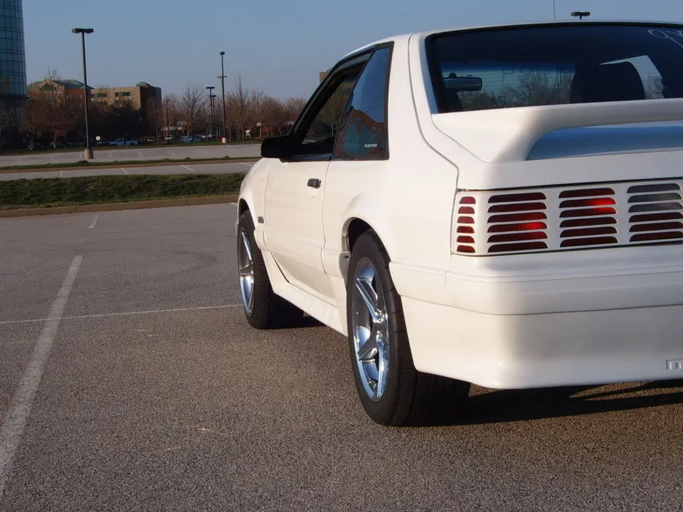

it'll probably be a bit big unless you go nittos (theyre always narrower than what they say). would probably still work though. just for reference a 275 nitto dr on a 17x9 in the back
That was my thinking as well: that the 245 would expose too much lip. Very nice GT, btw. :nice:
