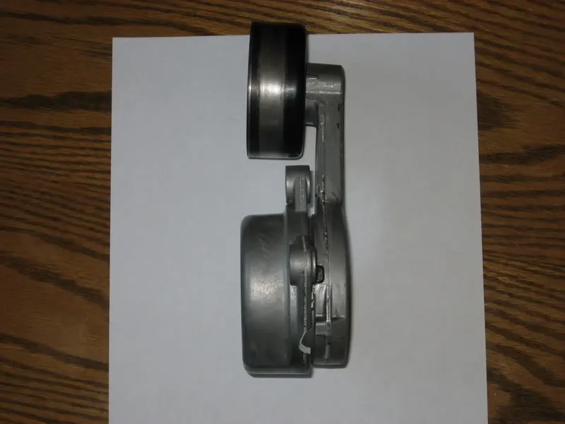

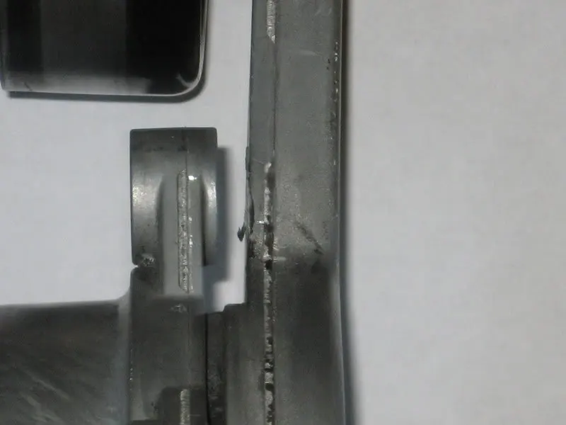

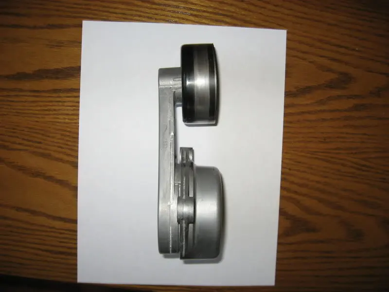

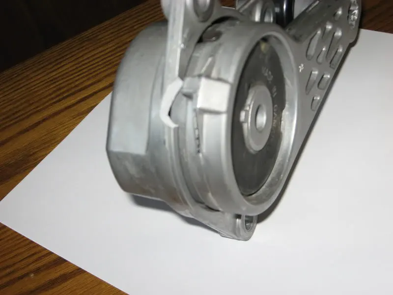

I don't know if you have an aftermarket tensioner but this is what happened to mine. You had mentioned you were having problems in the thread I had started in tech, here's what I found. Moral of story don't buy jobber tensioner, only buy Ford OEM!
Look how bent this piece of crap is, the pictures after will show why.
This shows how thick the bolt bosses are, the tensioner would ride up on the heads of the bolt forcing the tensioner arm outward or just hanging it up, the Ford OEM piece is about half as thick.
Where the piece that is supposed to keep the tensioner from moving up to far USED TO BE!
Just a close up of the broke off "bump stop"
Just another shot of how bent it is.
I got this piece from a local autoparts store, never again. Ford OEM all the way for me for external engine parts unless absolutely neccesary.
