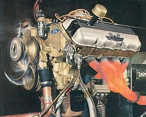

Mine burns 87 from whatever station is the least expensive. The fuel grade you need to use depends on the compression and timing of your engine, not the age. An SOHC 427 from 1966 will be hard pressed to run ping-free on modern "premium" since it had something like 11.5 or 12:1 compression out of the box. Back then you could easily get pump 100.
Yes, Over Head Cam.
an SOHC 427 was a special order option back in the mid to late '60s. The dual quad was rated at 657hp stock.

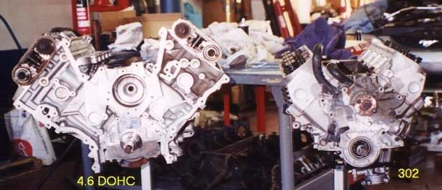

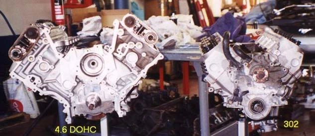

Until CNC machining started coming into common use, OHC heads were alot more expensive to produce. They have their advantages, but it baffles me as to why everyone is abandoning pushrods for production applications. They really shine when you need to control more than 2 valves per cylinder or vary the valves' timing independently. That makes me wonder if there is actually a point to having a 16v SOHC 4.6L.
