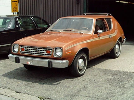

Man, I was really hoping for one of these:
