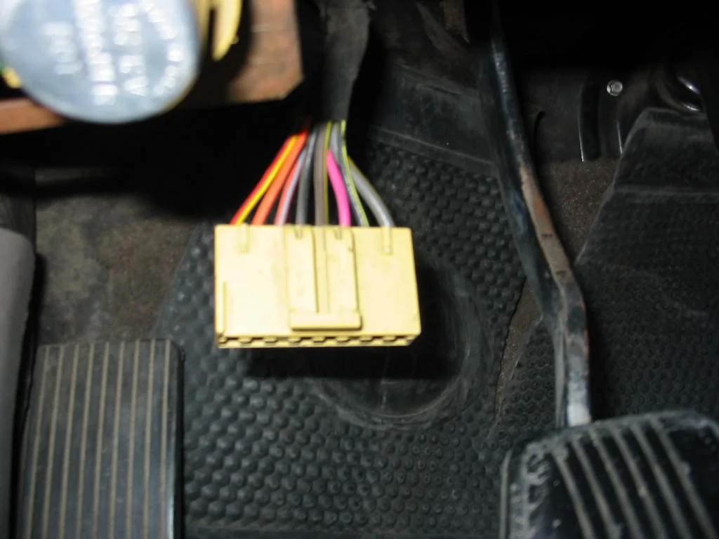

This I found hanging under my dash and i cant find a receptacle for it....
can someone tell me where this goes, or what i am missing?

from the size of the wires, it looks like the fan controller module plug, from the 2.3's that is probably why it does not connect to anything. cruise control amplifier does not have that many wires.
Hey now, you made me think............ I hate that!
I started picturing the CC amp - it's two separate sections of connectors IIRC. Then after Superhuaman's post, I did a little digging because I recalled a similar thread not super long ago. I think Superhuaman gets a cookie.
