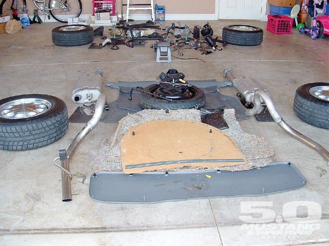

This is Sharad 's car:
http://www.mustang50magazine.com/featuredvehicles/m5lp_0812_1989_ford_mustang_lx/index.html
Did you actually read that article Nik? He barely squeaked into the 12's and put out plenty of cash and did away with all kinds of amenities to do it. Not to mention he had to run the car within and inch of it's life to do it.
Nothing about that read sounded simple.
No a/c, power steering, or smog equipment. No swaybar, removal of various front end bracketry (safety concern). Stripped interior components, etc.
Just look at what he stripped out of the car!?!
He then added an electric fan, battery relocation kit, aftermarket CAI with MAF meter, O/R mid pipe and dumped exhaust system, gear swap with drag wheels and tires, upper and lower control arms, etc.
Right there is not only a list of parts I would not consdider removing from "my" car, but over $3,000 worth of parts and labour just to do the deed.
Running 12's is possible with a stock-ish Fox body, but I wouldn't consider it easy, or cheap.
