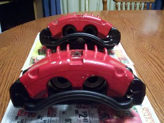

pbr brake caliper upgrade click on links for info http://www.allfordmustangs.com/Detailed/2009.shtml ................................... in this link click on 94-01 V6/GT & Fox3 (79-93 w/SN95 Spindles) Brake Upgrades http://www.svo73mm.cjb.net/

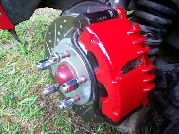

pics of my pbr brake upgrade...
