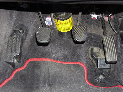

Or maybe something like this... Any thoughts? How would I attach something like this to the carpet? I'm not sure I want to take a drill and just drill though the floor.

You could just get a rubber door stop like this
and screw it to the floor board behind the arm of the pedal.

Dude when you did the gas pedal mod what did you use? A "C" clamp? if so you don't have to worry about is ever comming loose. As far as the gas pedal cable breaking that's not going to happen and even if it was I don't think a pedal stop would help. If I were you I would use a hood pin bolt or equivalent. Just bite the bullet and drill ahole in the floorpan if it bugs you that much.Thread the hood pin in/out untill you hit wot then tighten up the bolt and forget it! Just my 2 cents though.............jj
