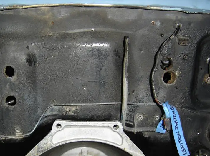

I need a pic please!!!!
65fastbackresto

On a 65, where the accelerator linkage attachs to the firewall. I`ve got the parts in now, just want to make sure I do this right, I wont have good access to this area after I stab the motor.
Does this give you what you are looking for?

That is EXACTLY what I was looking for.
Thanks man. I`m doing a 6 cyl to v-8 conversion, and it wasn`t totally obvious where the V-8 bolted on the firewall. I haven`t removed the old linkage yet, which is why I couldn`t see where the new one bolted up.
THANKS
