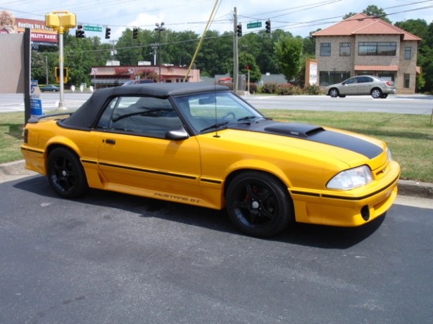

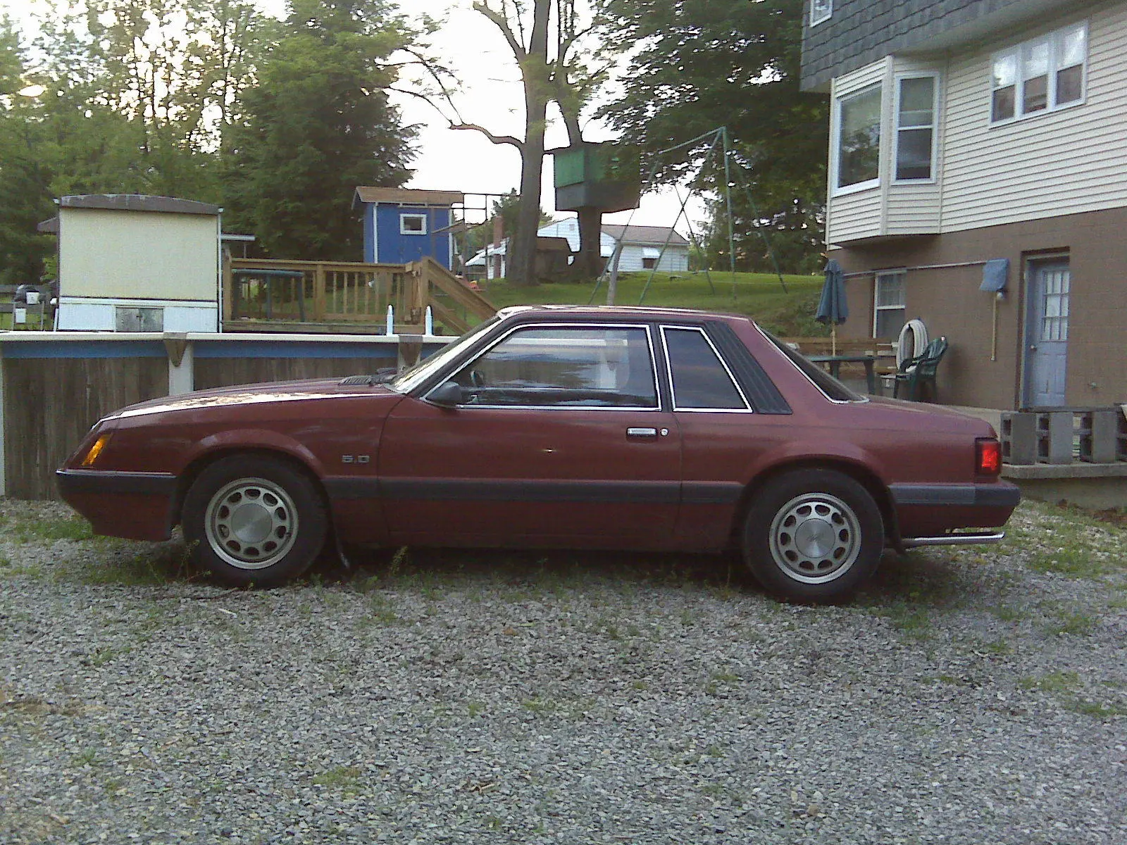

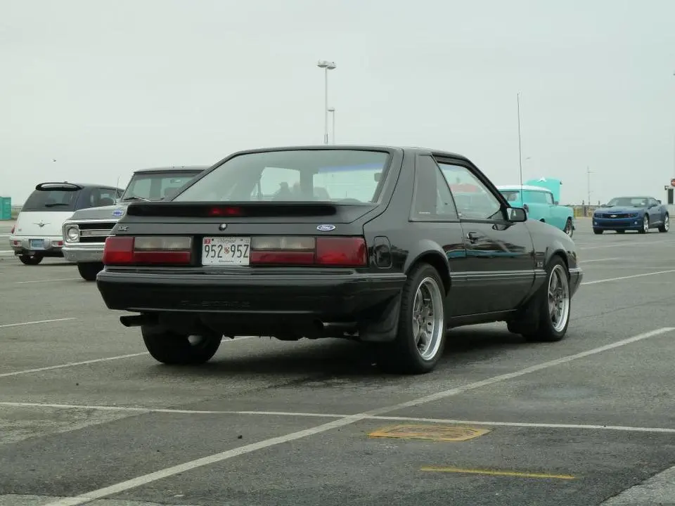

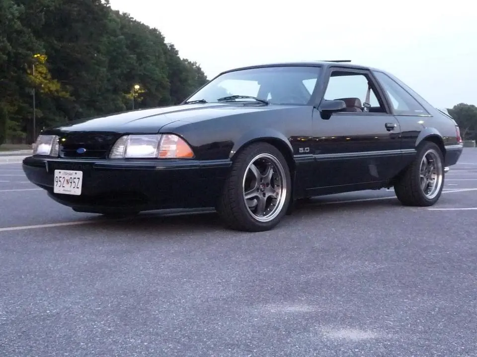

im about to start working on the my 89 and the first thing i want to change is the height. i came across this car that has a good looking stance. can anyone tell me how much it appears to be lowered and what springs to get? thanks

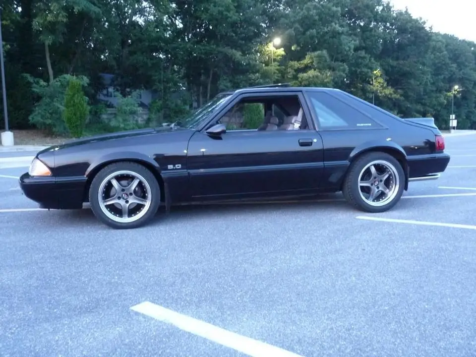

That's a 2 plus... Cant help you with the brand, I got BBK progressive and I think mine dropped 1.5 , I also replaced the spring rubber(forgot the name tech name) I go a pic but its a bad cellphone one from last year.
That car is not just lowered, it's slammed in my opinion. It's impossible to tell what springs are on it, it could be cut coils, replacement coils or even coil overs. You will need at least a 2" drop to achieve stance like that and don't plan on it riding that nice afterwards!

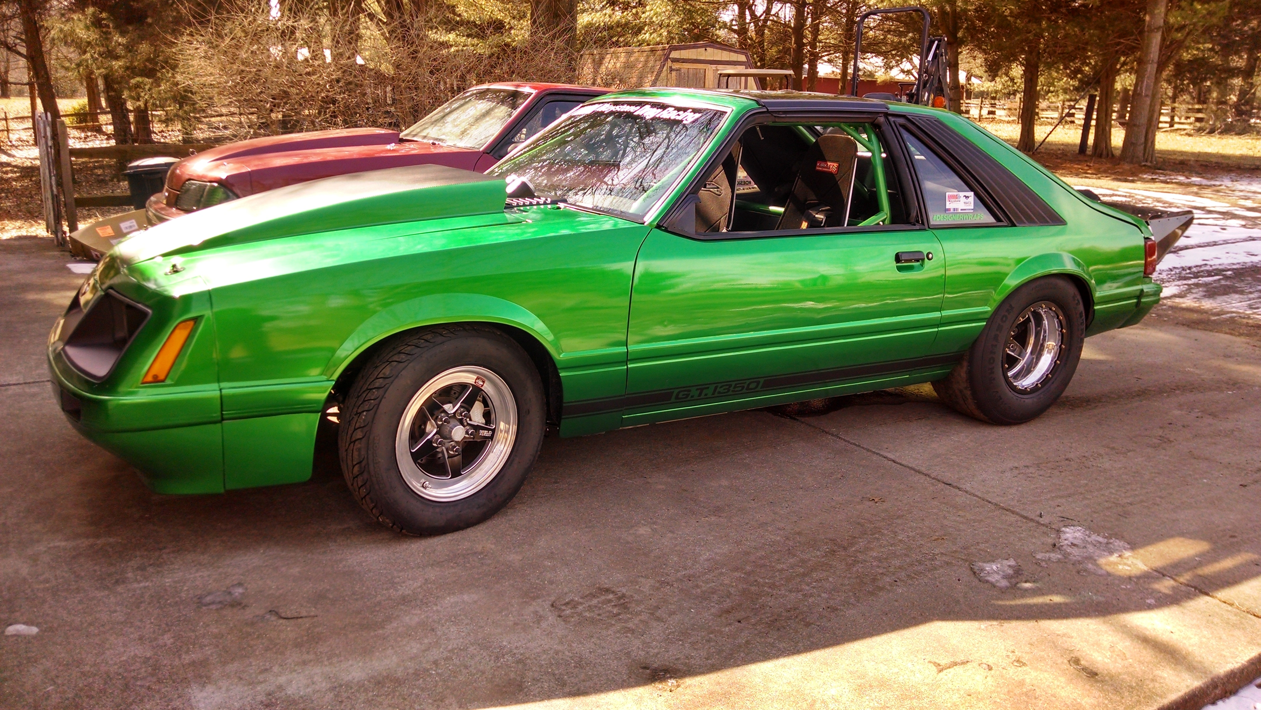

This is mine with coil overs on all 4 corners:

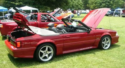

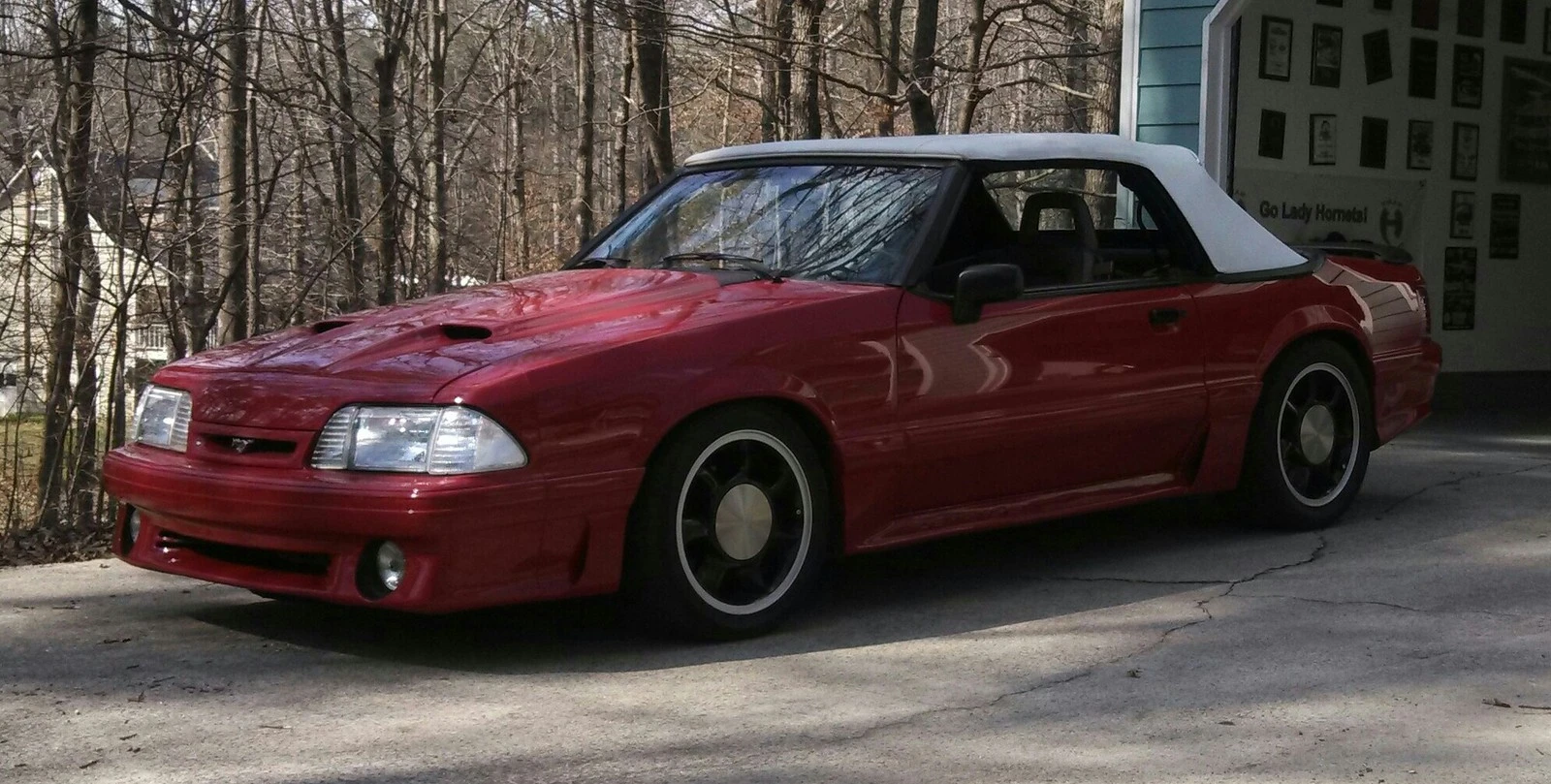

Here's a couple spring option pics for your reference.

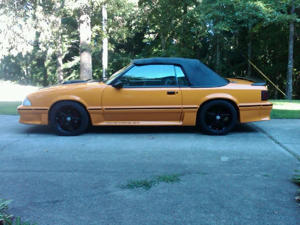

FRPP "B" springs are reasonably priced springs and look nice on a fox. Here's a pic of my old '87 vert with B springs and otherwise stock suspension.
I thought it sat real nice. "I miss that car"
My red '88 sits on Saleen Racecraft springs with a half coil remove from the front springs.
Very similar to the B springs.

i like your style, thats exactly the look im going for. how much of a drop is on the red one? beautiful cars man.
i just looked up the frpp b springs and it says , 1979-1993 Estimated Drop: Front 7/8"; Rear 1/2"... its looks alot lower than that. do you know of any other springs on the market that have close to a 2 inch drop?

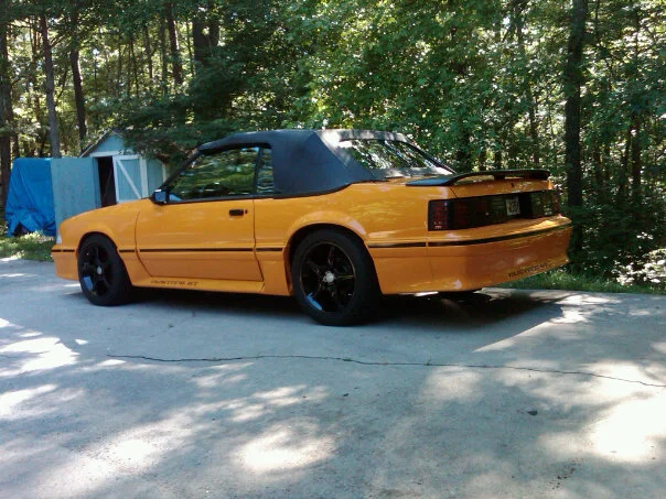

do you have any other pictures of the orange car? if i can get my car lowered like that i would be satisfied. still wondering why it says 7/8 - 1/2" though
I sold that car 3 years ago so I'm pics limited. LOL
Here's a couple more pics.
7/8" means drop in the front and a 1/2 in the rear. I think that is a ballpark figure because springs act so differently on different cars. However, I had these same B springs on my red vert for Years and decided to remove and use them on the orange car when I restored it. Both my verts sat nearly the same.
Here's an oooold pic from 2004 of my red vert using the same B springs and wheels that I later transferred to the orange vert.

Coil overs are the only way you will get slammed like that. You might get close with Eibach sport lines. When you go that low, Don't forget to order your C/C plates, off set steering rack bushings, bumpsteer kit and, possibly ball joints. Might has well put new control arm bushings in while you have it torn apart.
