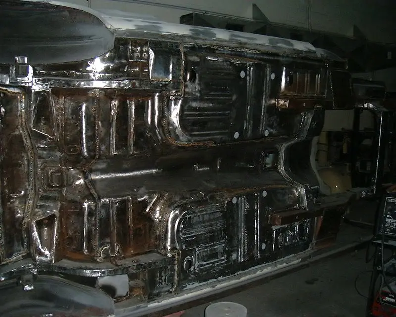

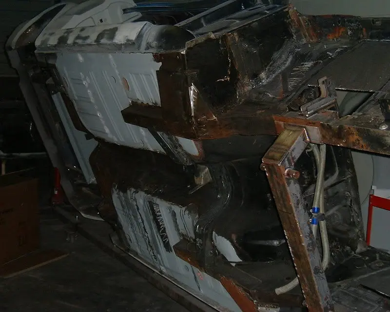

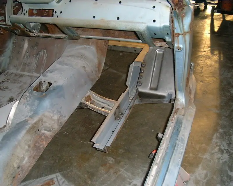

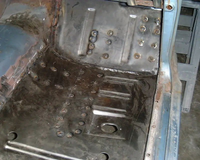

Is it the firewall that is bad or the toe boards? Both of these cars had the toe boards and torque boxes rusted and one we replaced the right frame rail. The frame rail attaches to the torque box and than the toe board goes over it. You should be able to replace one at a time.

It is the firewall as well that is rusted up by the cowel pannel and outside the rear fender apron. Could i replace the firewall first without removing the fraim rails and fender aprons since they attach to the tourque boxes and then remoce the boxes weld in the new ones and then the frame rails one side at a time? or do you have to dismantle the entire front end to replace the firewall? I emailed you some pictures as well so you can see what i mean.

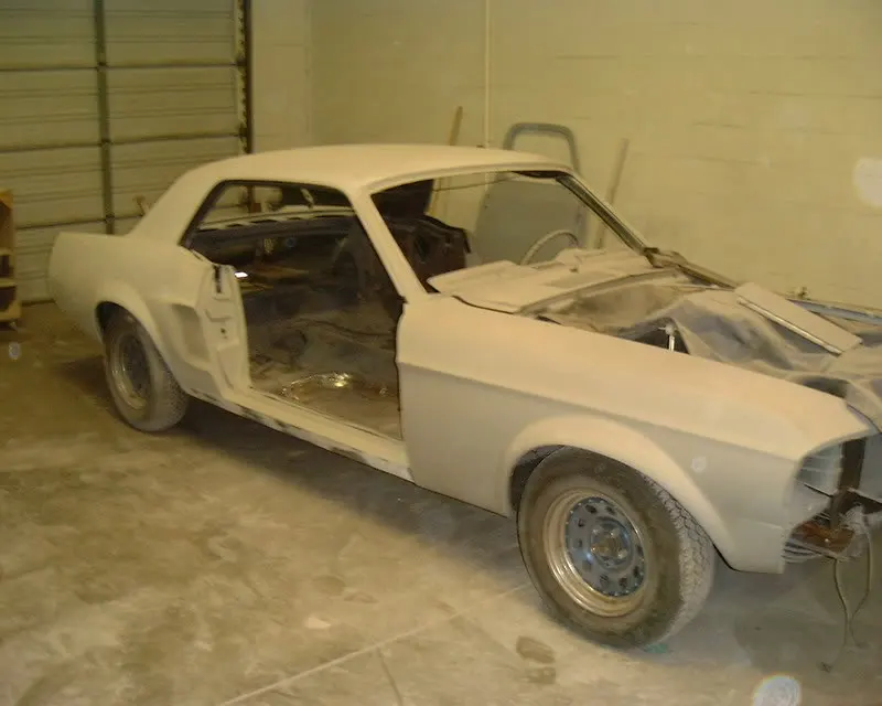

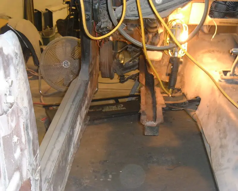

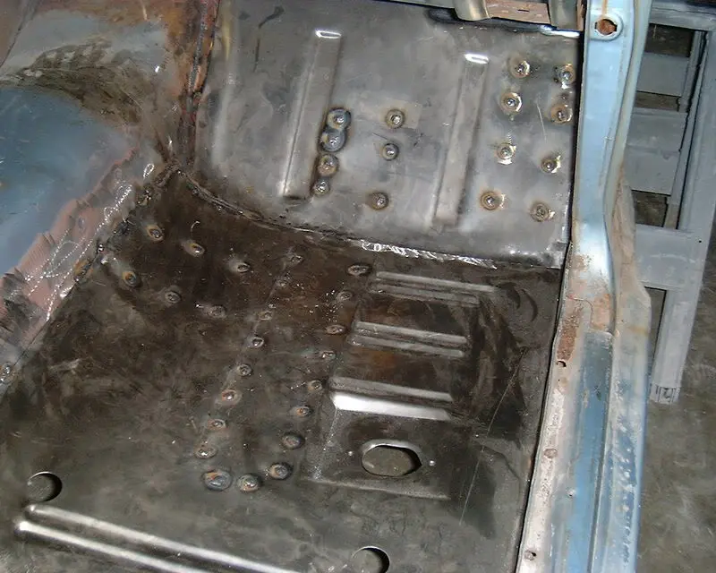

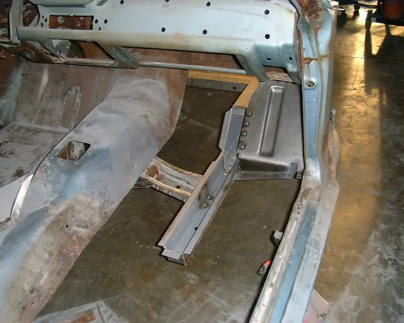

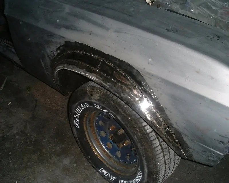

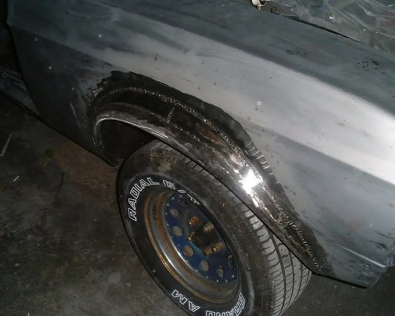

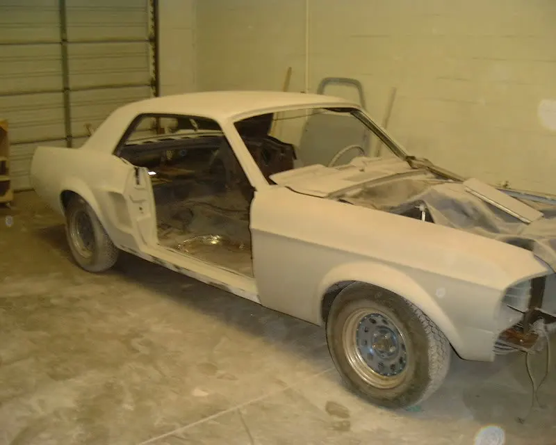

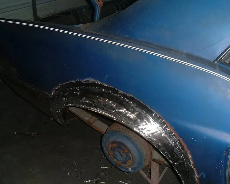

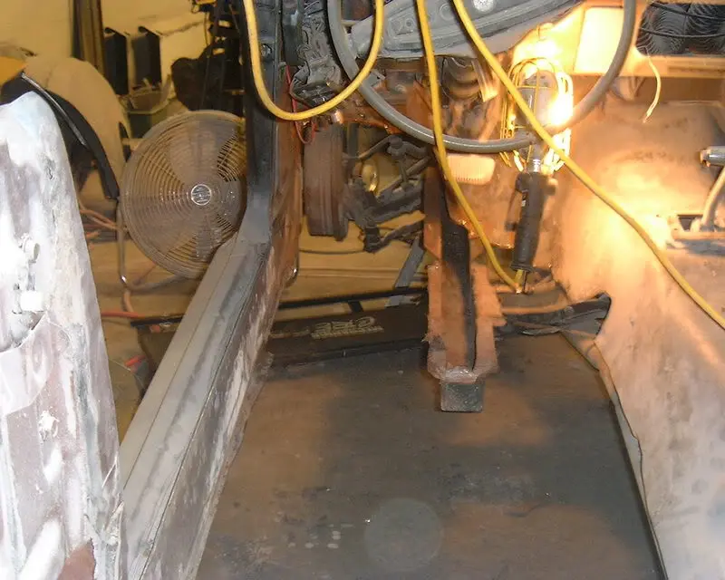

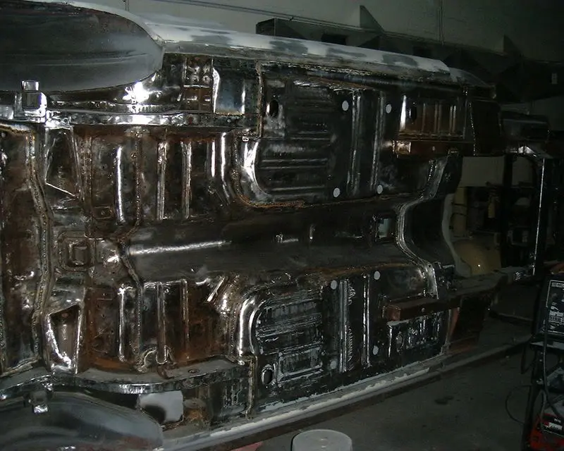

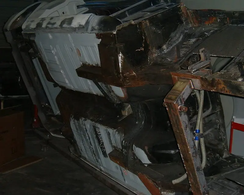

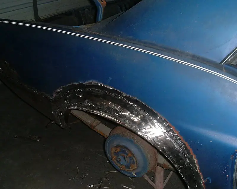

I'm building a 68 Coupe that has Rod & Customs Mustang II front suspension and their coil over rear as well. It will have a DOHC 4.6 from a Lincoln Mark VIII. We have replaced the floor pans, torque boxes and trunk floor and I flared the fenders.
