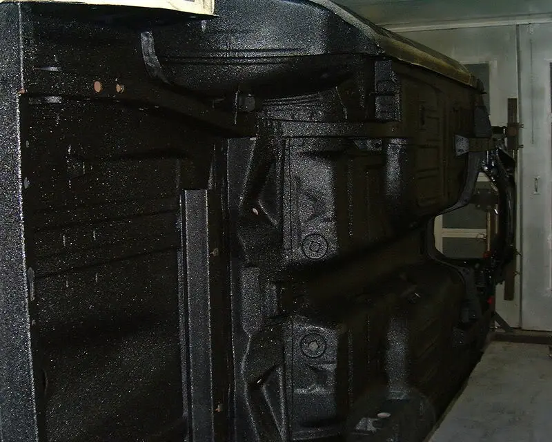

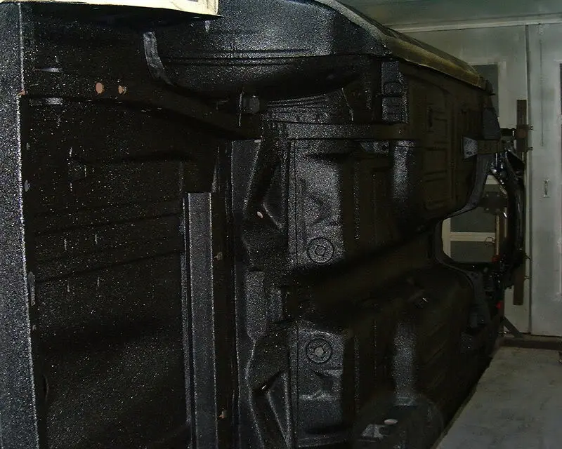

I was considering using a spray on type bedliner material for the undercarriage to prevent rust once i do all the repairs. Has anyone tried this and were you happy with the results? I plan on driving this car. Not just once a month and then cleaning every crevice under the car.
Ryan,
Check out www.southernpolyurethanes.com I use all their epoxy primers, urethane primers, clears, spray in bedliner and they also have some colors in my shop. They have the best products, customer support and prices. Here is a picture of a 73 Mustang we did and I will be using on my coupe as well.
