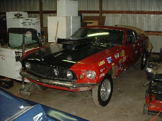

Here's the car as it sits now.... at least one shot to give you an idea of where I'm starting from....
Then definitely go in the retro-Super Stock direction. It's already started. Now, go find period pictures!
