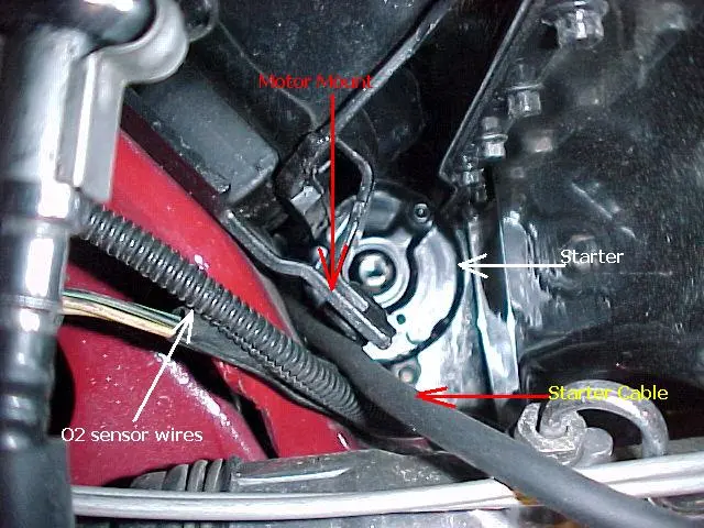

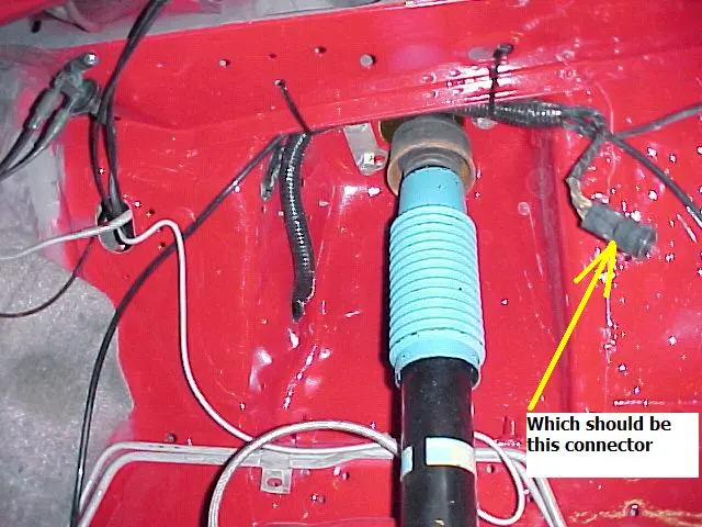

I’ll be glad to help you all I can if I can but my 89T GT could possibly be different than your 92 GT but I can show you how I routed my harness for my o2 sensors on my 89GT if you want.
The connector in this diagram below is the connector that goes to my o2 harness
From that point it heads towards the bottom of the inner fender and then under and toward the motor mount like in this picture
after that it then in then runs along the top of my K-member brace before it actually hooks up to the o2 sensors connector.
If you would; let me know if this makes any since you or not, or if you need a better explanation of what I did, I’ll be glad to help you all I can.
