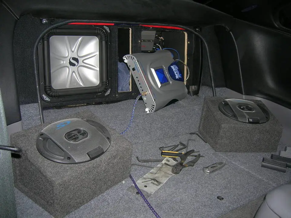

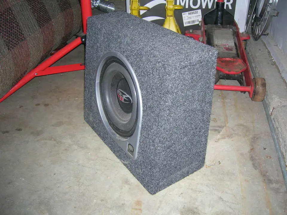

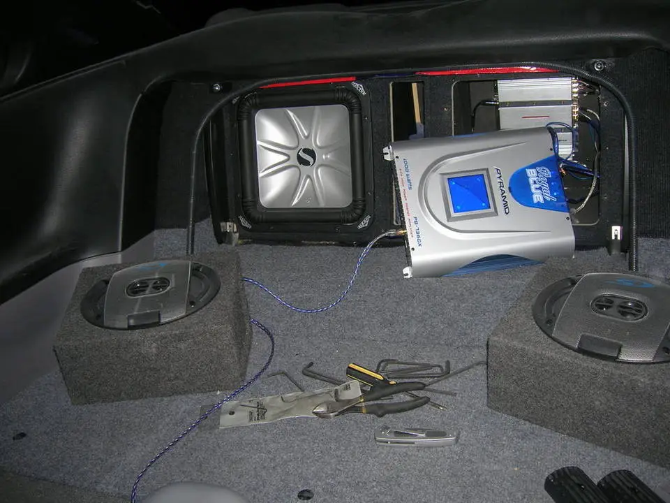

I think the spare tire well is your best bet, unless you want to keep your spare in there of course... What about a single 10" or even dual 10's in the trunk, but use truck boxes? I have a pic below of what style box I mean, except mine is an 8" sub that was free. Here are also a few pics of my setup in progress. I got married on saturday, so nevermind the mess, cause Ive been busy. I used a single 12" Kicker solobaric L5. Its just a middle of road sub in their lineup right under the L7, but produces plenty of bass for me, hence why I am only using one. One of them in you spare tire well would probably do the trick. I bought mine off ebay refurbished for $99. So far so good, as you can see I wired the amp up real quick just to test it. Mine sounds great even with a cheap ass Pyramid amp, so I cant wait to hear it when I get a better one. I hope the pics arent too big, cause I just threw them up here quick without resizing!
