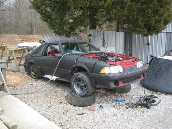

Hey I'm looking to buy 2 fox body GT's. I was on here awhile ago and I saw a forum about all the places that the fox has a weakness to rust. Here's what I was wondering. Can someone either find that forum for me or if not then could you just tell me all those places that it rusts? If so it would be greatly appreciated.
I just thought I would put up a pic of the one I have a pic of. It's an 88 GT. I don't have pics of the other one yet. But if and when I get one I'll put it up.
Just on the body; the front strut towers and framerails, especially on the drivers side. Behind the front fenders where the door hinges are mounted, pass side quarter panel fender flair, rear lower quarter panels, underbody around the gas tank, and under GT ground effects.
