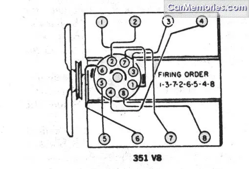

To get top dead center remove all the sparkplugs, rotate the motor while sealing the #1 sparkplug hole with your finger when the air pressure blows your finger off the plug hole you are on the compression stroke. insert a screwdriver carefully into the plug hole and rotate engine slowly (dont let the screwdriver bind) until the top of the piston is all the way up this would be top dead center now wire it up as in the diagram below..

I know I'm bringing a very old post to the top and I apologize. With that said, I have to thank the above poster for his comment. I've been struggling with my '74 351W in my '58 F100 for two summers now. I could get it to idle great but anything above idle acted like the timing was off. I've gone from an MSD box running a Duraspark II distributor, to a complete Duraspark II system, to a Mallory one-wire, GM style distributor all with the same result. I had it timed at 13726548 and never even thought to try 15426378 until I saw that post. I just swapped those four wires and it runs awesome and just chirped the first brody since 2010. I was this close to selling the thing. So thank you OonDeanisS, if you're even in Rockford, IL I owe you a beer or 2. To answer your question, yes, it is possible. Out
