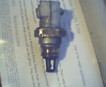

Thanks. My EGR is non functional. I just purchased a voltimeter and would like to test my TPS for proper adjustment, does anyone know A: what range to use B: what my reading should be at idle and C: which wires do I pull from?
My O2 sensors are both pretty new, but if the TPS turns up normal (brand new just installed) then I will definatley check them out. I also purchased a brand new timing light and will be checking that out.
looks like this
