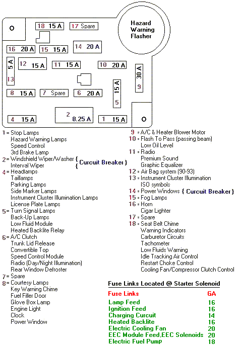

have you checked the fuse to make sure it wasnt blown? I didnt see that in the list of things you checked.It's fuse 5
