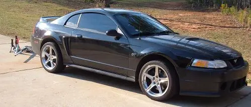

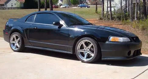

i will try to put more up later
kstang69 said:
lower than i thought in the front, but i want it to be even in front and rear, i dont want raked look, so i will remove the rear isolators and leave the front.
i am working on getting the pic right now will post in a few mins.
If you want a more even stance, front to back, you can also cut the dead coil off of the rear springs and it will even it out. I think that you will still have the raked look if you remove just the isolators, but give the isolators a shot first.
Pics look good, though.
