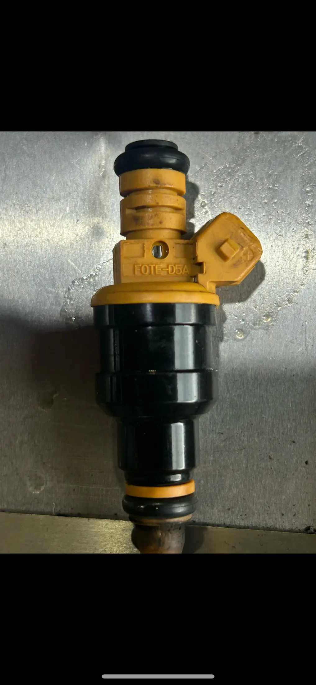

Thank you. The car is 1991, the engine is 5.0HO, the injector is FOTE-D5A, and the ECU was replaced with an ECU exchange the other day.The head is also rebuilt and the engine is not a stroker.

What size are the injectors you've installed? You've replaced the regulator as well, have you verified what fuel pressure it's actually sending through the injectors?

The fuel pressure regulator has also been replaced and the fuel pressure is being measured.
So you have 20 lb/hr injectors. Stock is 19 so that could contribute to it running fat as the tables in the ECU are configured for the 19 lb/hr injectors. I am not saying that is it but it may not be helping.
Yes. I am also concerned about the injectors I replaced. Some websites say 19lbs or 20lbs, so I was wondering. Do you know which injectors are the correct 19lbs injectors?

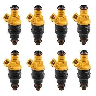

This is the correct size/style for a stock 5.0.
