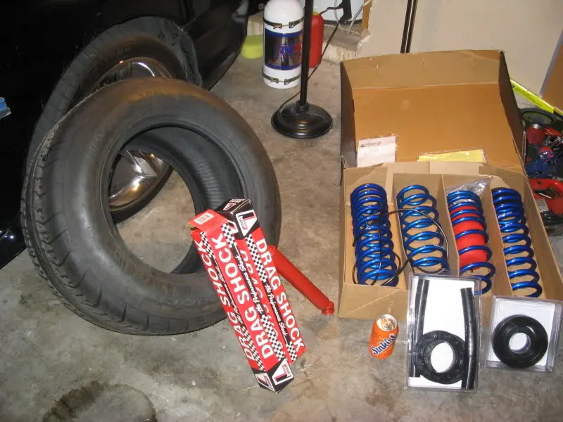

6.5" backspacing i believe, why 15x10 rims??? i have the 15x8 on mine and i can fit a 10" slick or my street et radials which are 275/50/15. i know that the 15x8 are a 5.5 back space
sweet thats awesome.. I said 10 because i figured i needed a wider rim for the 10" slicks. If 8 will do it I am all aboard. thanks for the input.. looks like 15x8's with 275/50/15.
