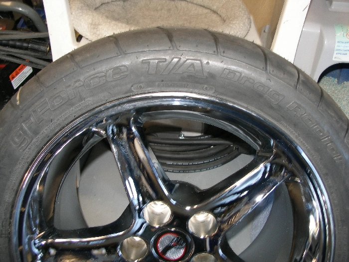

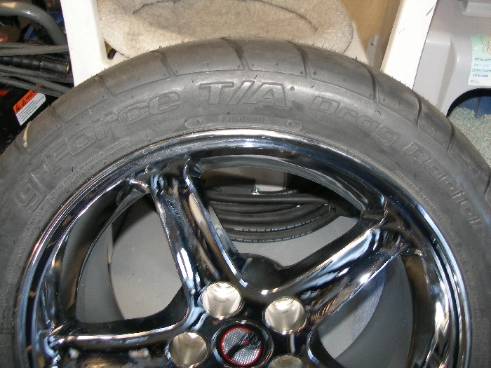

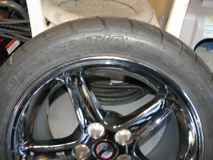

If you want to hook, get some BFG TA/Drag Radials. You will hook.
They are really soft though. I wouldn't use them as a DD tire. Mount them on another set of rims and put them on when you want to have some fun or go to the track.
I hope to be in the 450 rwhp range so anything less than ET Street radials is a waste of time. I have had a set of the tires your talking about and for the power level i had @ the time they performed well.. but anything over that and they are as good as street tires.

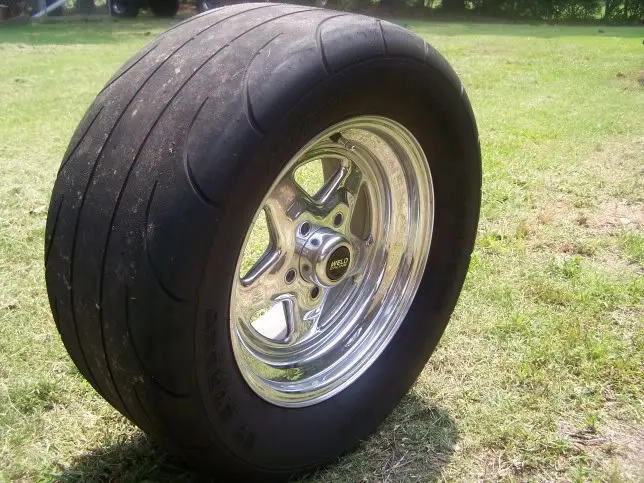

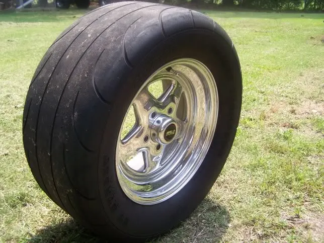

BooWFO said:
Your going with a 10" wide rim. hmm 10.5w's.
Et streets are nice hook good on the street and fair at the track, but don't get caught in the rain. Cause you might as well be on slicks. Trust me I know.
I have run them in a 17 on the street in the rain... never had any issues, but then again these are track tires for the most part.. maybe the occasional run to the hang out in them. which is less that 3 miles from my house. I was just wondering about rim sizes.. and what would be the biggest tire I could get away with on those rims.
