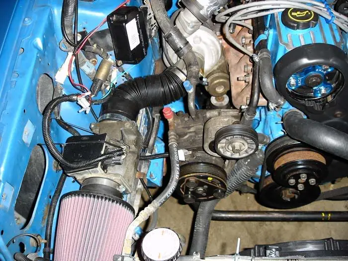

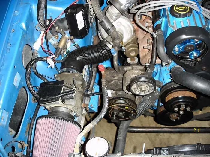

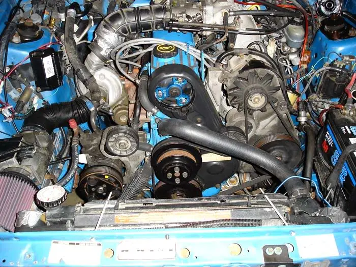

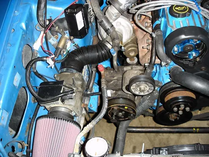

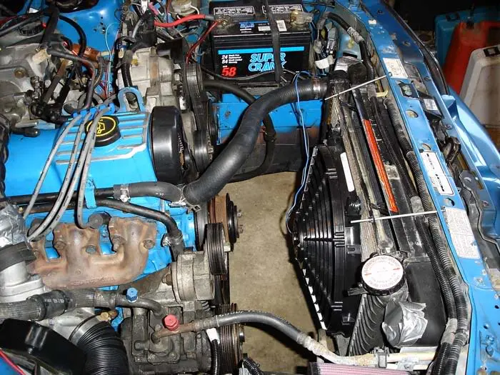

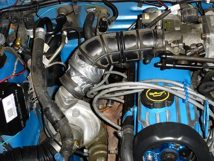

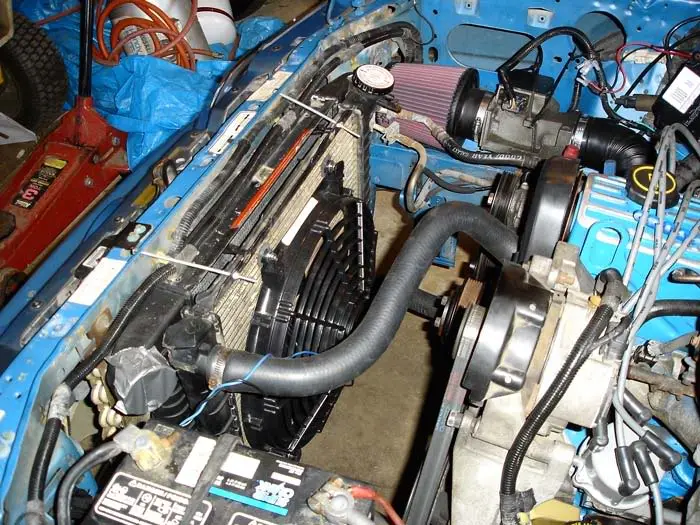

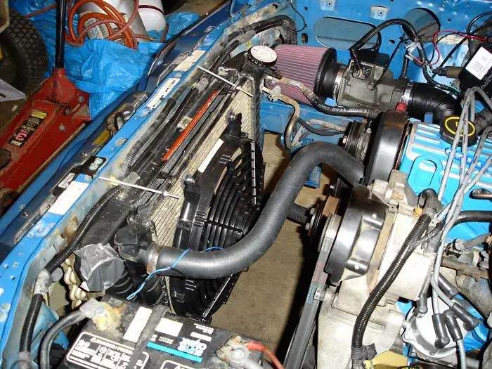

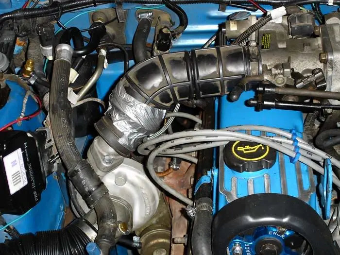

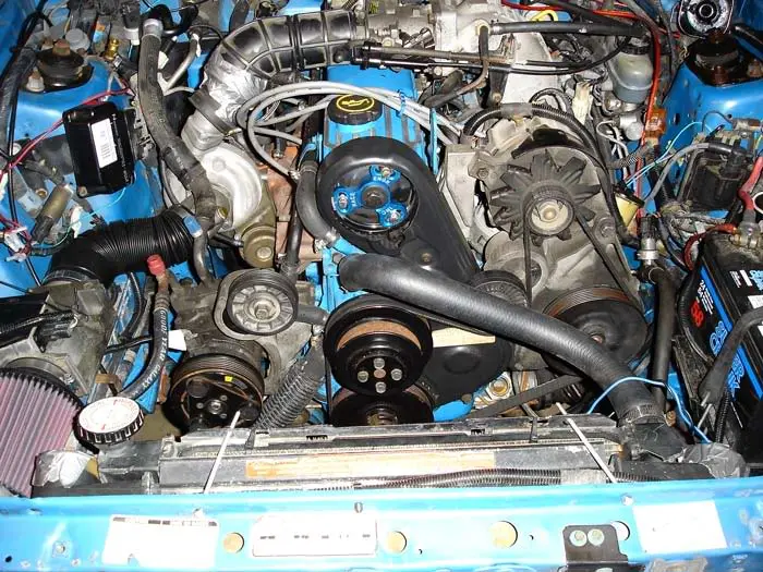

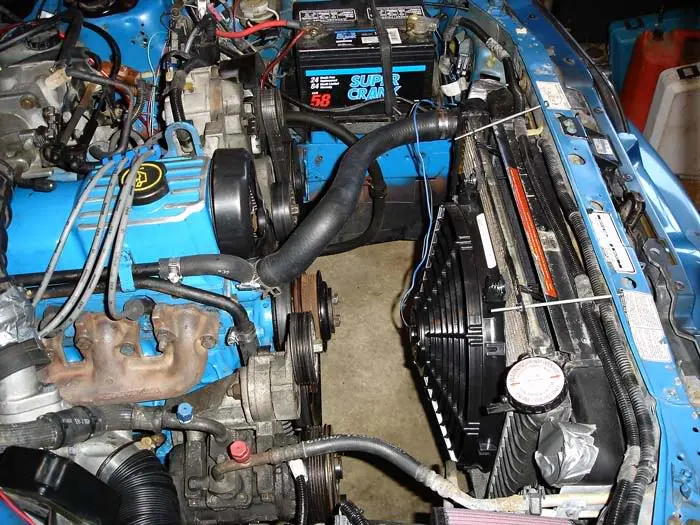

Heres what i have so far.. the IC is mounted, but the fan isnt wired yet so its just tied to the hose, and the hose that connects the turbo and TB blew out (see other thread) so the ducttape just allows me to start it. It wont drive like that.

you can sqeeze a 2.5 silicone coupler down or up to +/- .5 . Just make sure your clamps are upto the task.

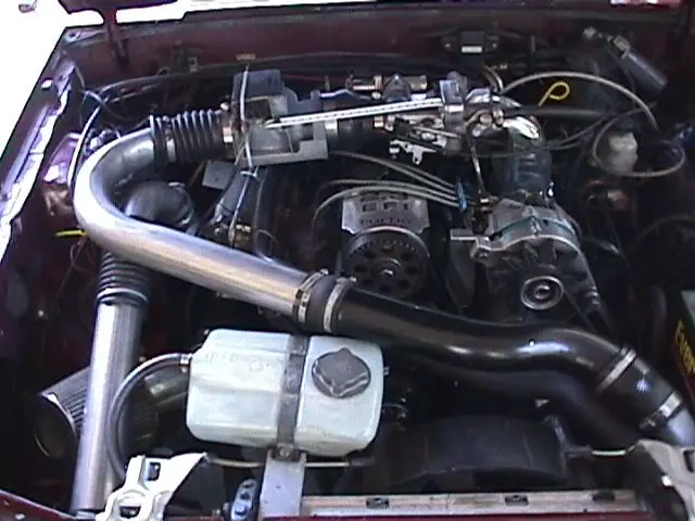

Here is a picture of my first "plumbing" when i got the motor going. Basicly its 4-5 pieces of crush bend with lots of rubber and lots of clamps. (this was when i had a blow-thru vam)
1 long straight run with a 90* crush bend for the turbo-to-intercooler
2 pieces to make that wierd turn from the I/c to the black pipe
1 Volvo pipe (hey i picked itup for cheap, figured i could use it)
1 almost 180* bend from volvo pipe to vam.
The last bend is usaly the hardest becuase it has to be tight, and doing a 180* with a crush bend setup really
A: challenges the person forming it
b: Makes it hard not to kink the pipe
C: shrinks the pipe quite badly.
It's not pretty, but it worked for awhile until i got around to doing it the right way. :)
