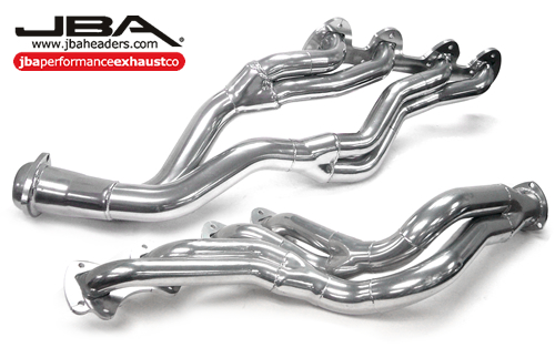

The heads need the Mustang/Cougar pattern for anything stock, but some of the Mustang/Cougar headers will fit the big car pattern, too.
