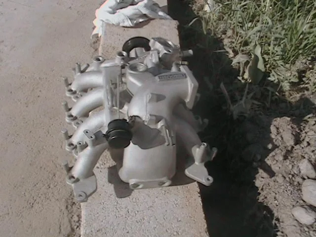

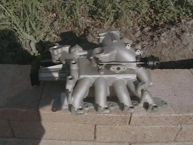

I bought a 97 GT and the guy gave me this Roush supercharger with it. He had no idea what it fit. Can anyone identify it for me? I don't have any part numbers. All I have are these pics.
I have more pics on request

That came on the stage 3 roush in like 98 maybe 97 too...Smoke would know better or err BLK ROUSH,
Did they include anything else with it or just that main unit? You need an install kit to put it on your car which includes relocation brackets/hardware/hoses etc etc...will cost you @$1100 from Ford for the kit.
Anyone have any idea what the boost numbers are for this unit? Or what kinda HP gains can be made? Also, is there anywhere I can access this info? I looked on Roushperformance.com and I found nothing for 96 to 98's. Is the install very difficult? Is there much to buy to make it happen? Thanks for all the help!!!

stock 3.5" pulley = 6psi. I made 422/402 rwhp/rwtq w/ that unit on a PI motor w/ bolt ons and crower st. 2 blower cams.
Its not a hard install, its just got alot of specific parts that must be purchased to install it.
Which you can only get from ford racing, or by fabricating and machining them yourself. the install kit is like $1100 which includes a ECU (which is junk, get a custom dyno tune), fuel pump, injectors, misc hoses, brackets, hardware, etc
