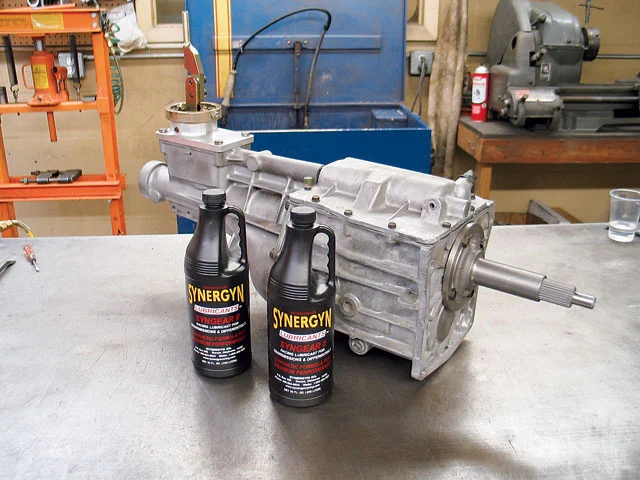

Does it have a wood frame inside the box? I shipped a T5 (one from a 1990 Mustang), the tranny weight was ~75-77lbs, but by the time I built a reinforced crate and added cushioning foam and a cardboard shell to it, shipping weight became 90lbs. The 92lbs isn't that far off if they added structural cardboard or fabbed a crate. Also consider a beefed up gear set and a steel front bearing retainer will add a bit of weight.

I wouldn`t have thought it, but maybe it could of.
My transmssion looks exactly like that one, so it must be T-5.
I was worried more then anything that if it was a tremec, that my install guy would have to raise my transmission tunnel to make it fit. I dont need any unexpected expenses on this one. I`m lucky the wife went for this at all.....
Oh by the way, that oil your showing in front of your T-5.....I dont think thats what your supposed to be running, supposed to use automatic transmission fluid in these is what I read....

You are correct about the ATF. The pictures are file photos from various magazine articles. I used Amsoil synthetic ATF and have been very happy with it.
