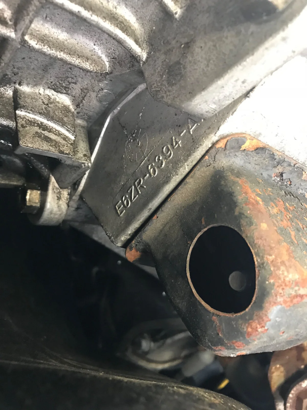

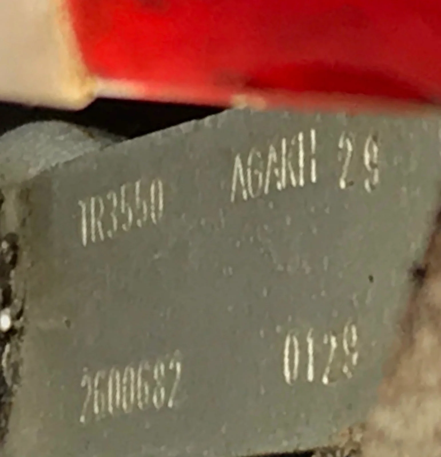

Ok, so I have a similar post on the corral to see if anyone knows but as I'm continuing to find out more about a 93 coupe that I purchased - a few questions have come up. As I'm underneath the car pulling the driveshaft to replace a worn u-joint, I snapped a pic of the tag on the transmission - it has what appears to be a standard TR3550 part # 2600682. Then I notice on the bellhousing the part # E6ZR-6394-AA - which equates to a standard 86-93 T-5 bellhousing. I was under the impression that you needed a different bellhousing to attach a Tremec (3550)?

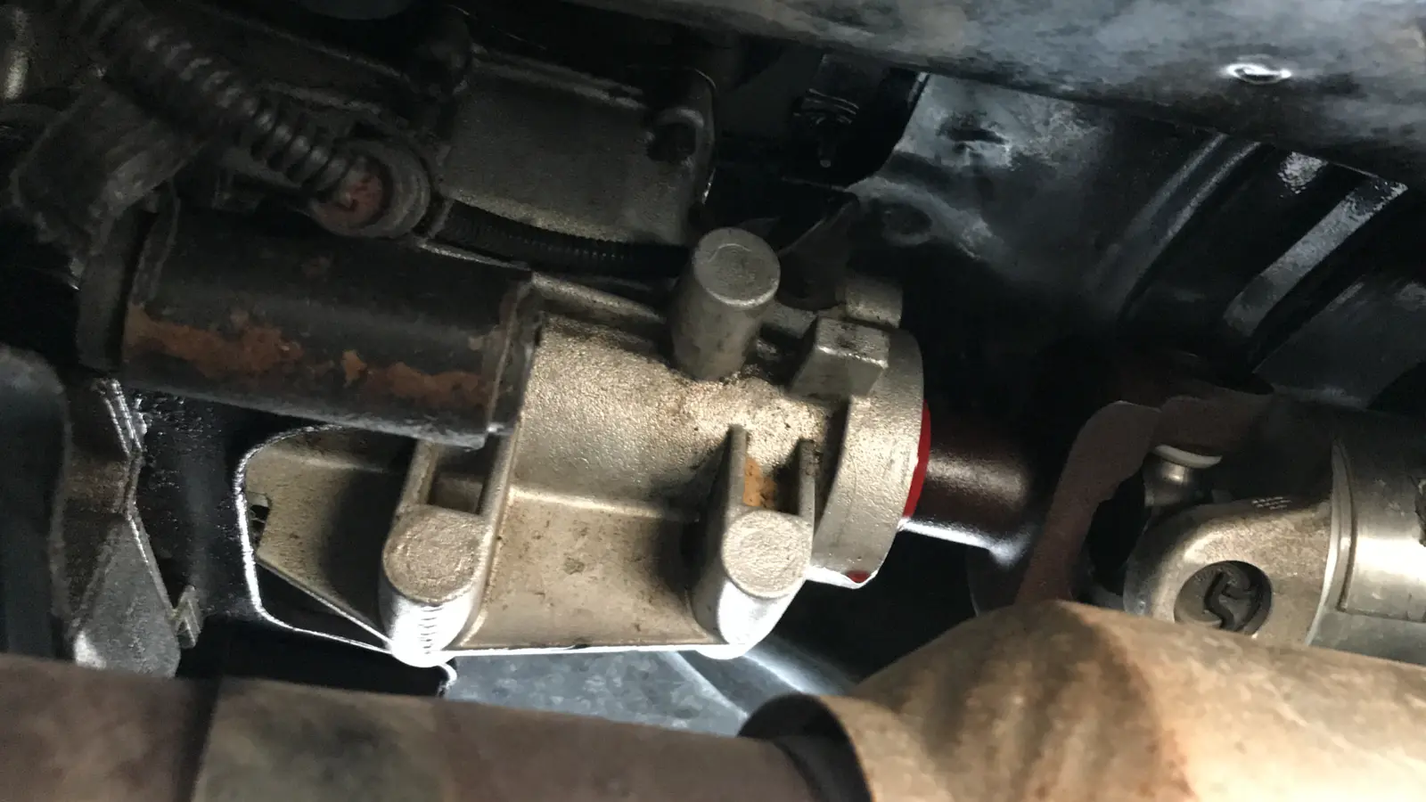

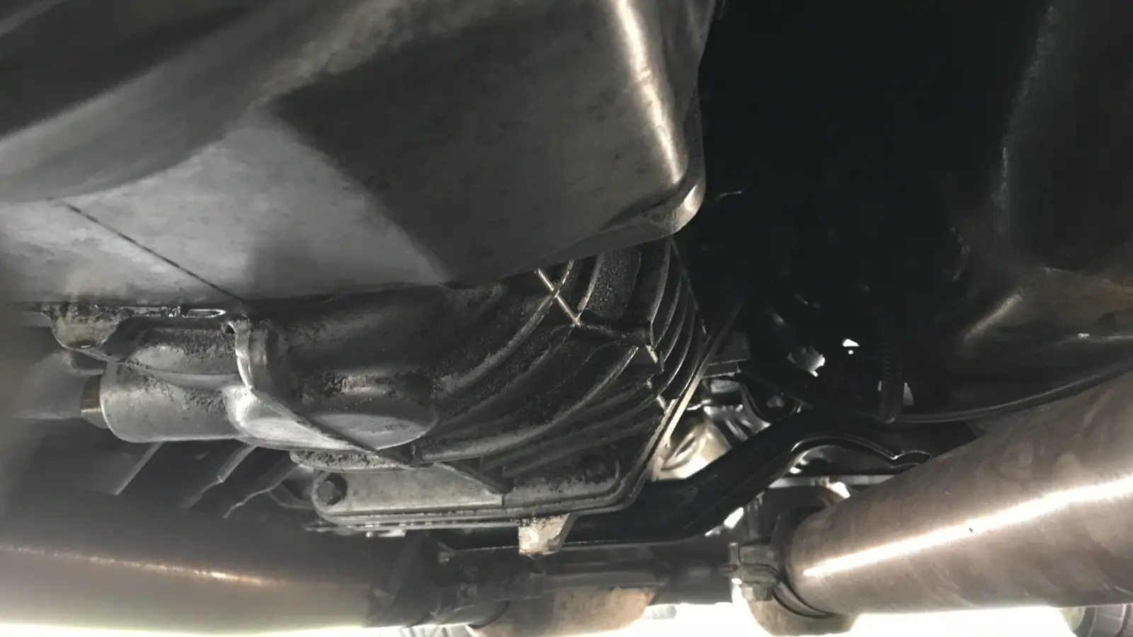

Pics of the trans itself?

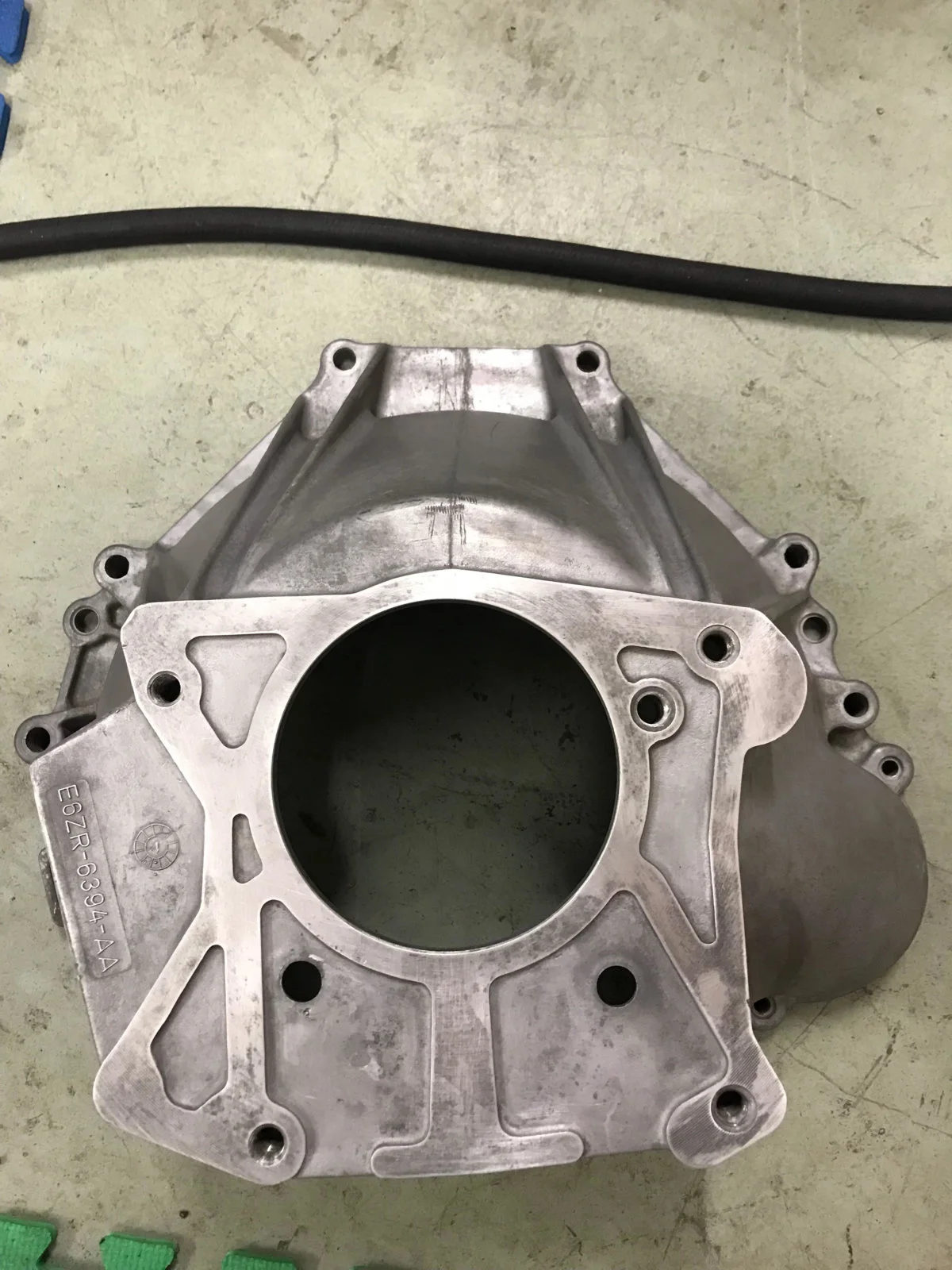

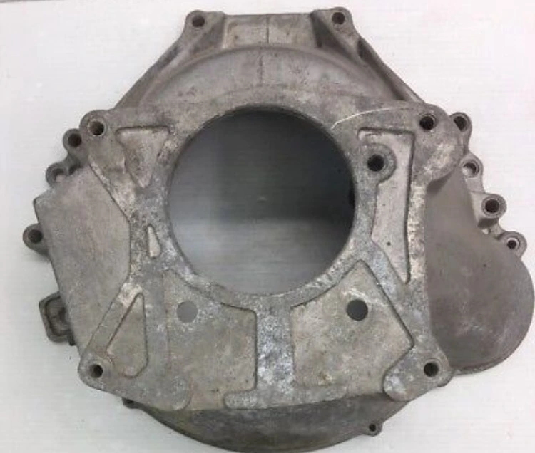

SROD bell

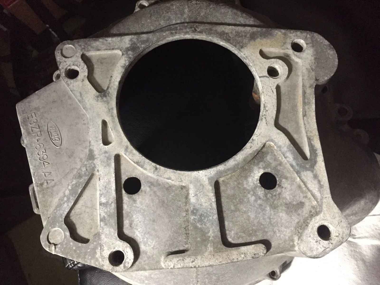

Vs T5 bell.
You can see the holes for the SROD/3550 mounting are present. Input shaft locating circle diameters don't look too far off. I don't have an SROD bell to measure though
Thanks Mustang5L5 - attaching a pic of a 86-93 fox T5 bell (E6ZR) - which is really the same as the E3ZR bell? I noticed it doesn't have the "locating" holes cast where you would need to drill and tap - so does this mean that they are all dimensionally the same as long as you tap and drill the 2 holes on left side? I know you said one - but isn't there 2 that are not in the right place (for a 3550)? The center hole looks like it's the same on all of them - just eyeballing it of course.

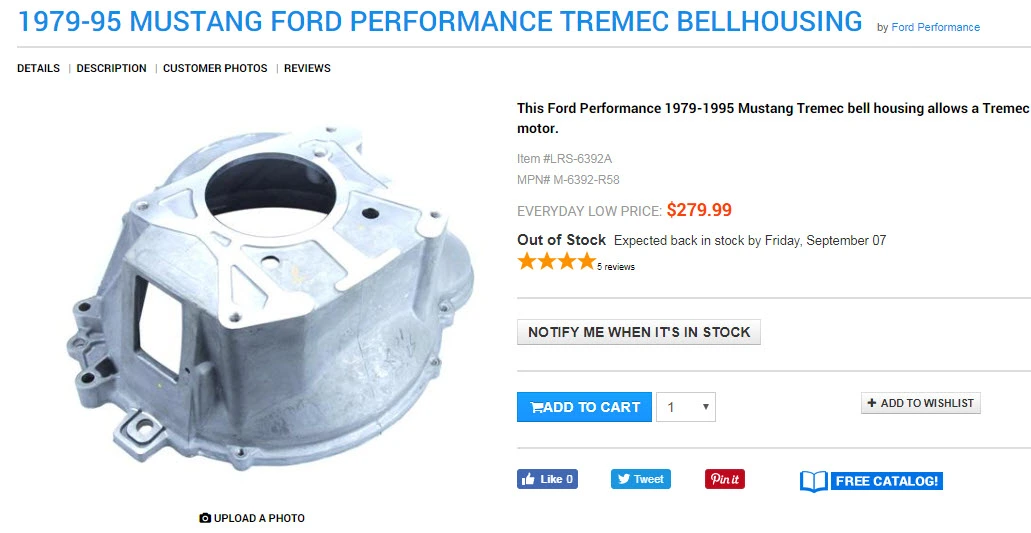

Also attaching Ford Performance pic from LMR showing the 2 holes that are present in the bell for 3550 - does the 3550 use both of these left holes or only one?
And also attaching pics of the trans itself - kind of hard with the phone...lol...but are you looking for something in particular?

Yes, two holes would need to be drilled/tapped. And the e3 and e6 bell ar essentially the same other than a few minor differences...the lack of the cast locating holes for the older SROD is one.
The SROD bellhousing is 79-83. Part number d9zc-6394-ba.
So what's the cons (besides the holes) with using the T5 bell? Does the difference in the center hole cause any driveline angle issues or does it really not matter because once it's bolted up it's not moving anyway?
Unfortunately I can't answer that. Best way to determine if it's an issue is to find someone with a d9 bellhousing and ask them to measure the center hole. They look pretty close so need to see if that's actually a concern.
My e3 bell is 4.90" in diameter. Just need to find someone with a d9 bell to measure
