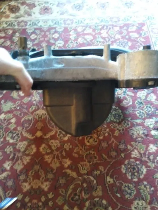

Two weeks after buying this intake on ebay it gets delivered to my house. It doesnt look like a PI intake......
The aluminum crossover is a good indication that it's a PI but doesn't mean that it actualy is since all replacement PI/NPI intakes had the crossover.

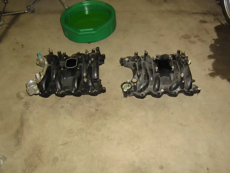

Here's a side-by-side (PI on the left)
Yours looks like a PI to me.
ok well judging guy the way my runners look it seems to be a NPI with alum cross. But the underside on both of yours seems to have a hole running the full length. mine is sealed at both ends.

That's a PI intake. The NPI intake runner holes are round.
Also, the front-most runner on the PI intake goes to the number 1 cylinder, whereas the front-most one on the NPI intake goes to the number 5 cylinder (as shown in the pic posted by Nightfire). Your front-most runner goes to the number 1 cylinder, also confirming it is a PI intake.
As for the hole through the the center of the runners on the bottom, Dorman makes a PI intake manifold that is a direct replacement for the later model 4.6s and their's doesnt have a hole through the center either. Problably isnt a factory manifold, most likely aftermarket.
yup you are most certainly correct. it is a dorman intake.

I still am not sure that this is a PI intake. the runners are no bigger then stock and it goes just as deep as the stock NPI I currently have.
But according to sneaky98GT the ports are correct for a PI intake as well as the first runner feeds #1 cylinder.
But dormans NPI intake doesnt have a "hole" going through the bottom, but the PI one they make does have it.....

I must first state that I mis-spoke earlier about which cylinder the first runner goes to. I forgot that 1-4 is the passenger side, while 5-8 is the driver side. So while what I was trying to say is still correct, the first runner on the PI intake goes to the #5 cylinder (driver side) while the first runner on the NPI goes to the #1 cylinder (passenger side).

In the pictures for each one, you can clearly see that the 1st runner on the 615-178 feeds the #5 cylinder and the runner on the 615-175 feeds the #1 cylinder (as pictured in your pics as well).
The runner locations and inlet shapes pretty much confirm that you've got a PI intake.
