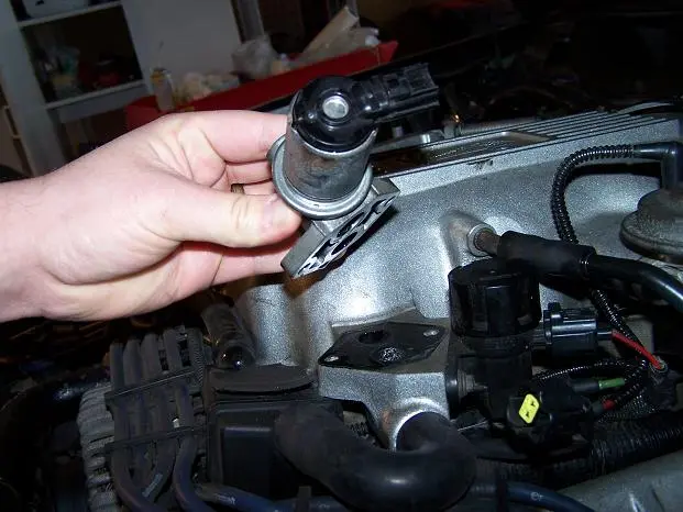

I just did a google image search and found this pic - I may be wrong about the location...see the attached photo.
Thanks guys, after reading many...many old posts, I got a discription. Long plastic tube in front of plenum that connects air intake to the IAC. I placed 1/2 copper end cap with 9/32 hole, put it in the side nearest intake and....viola....seems to work. Even with my 4v, the revs drop between shifts like I like them too.
