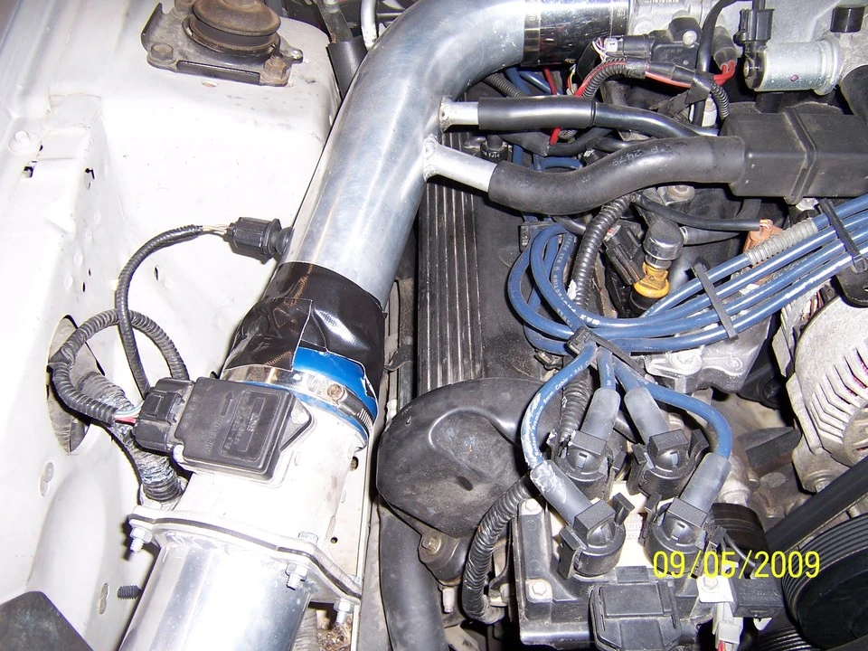

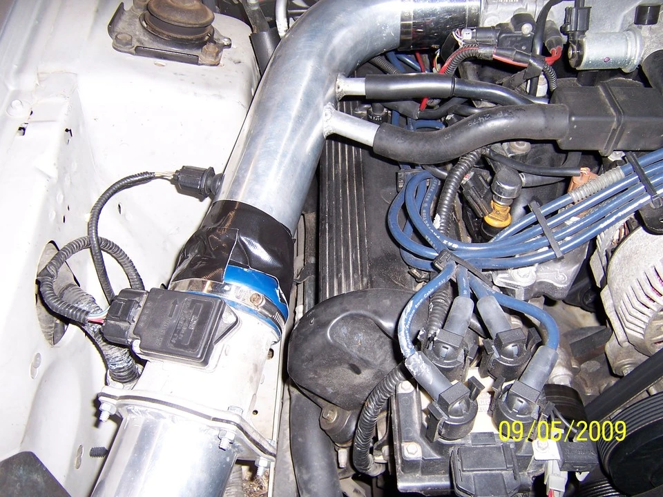

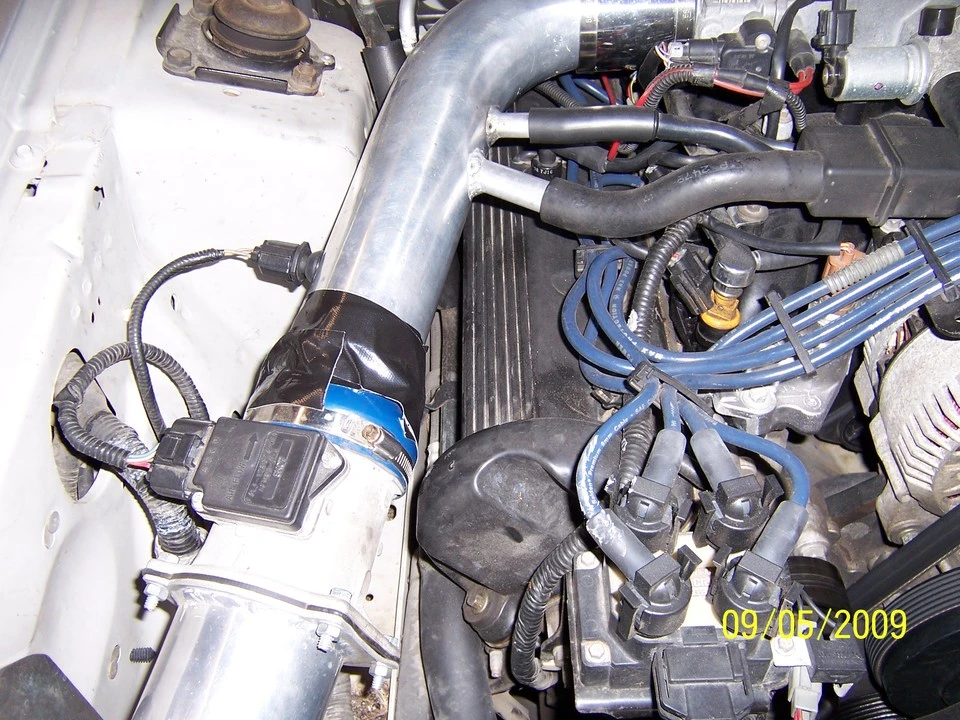

A couple of years back, I was out in the middle of nowhere about 100 miles from home, and I had the SAME thing happened. Drove it for a while before it finally almost wouldn't run at all. Stopped, hopped out and popped the hood, and low and behold, the intake had fallen apart just after the MAF sensor. Naturally, I didn't even have a screwdriver to tighten the clamp back up on it. The solution:
Duct taped that bad boy back up and drove it on with no problems.
Glad to hear you got your problem fixed!
that is what you all custom ingenutiy....you do what you have to do with the resources available right...:nice:
Thus the reason I'm always keeping a flat-head screwdriver in my car, them rubber couplers are flemsy at best:nonono:.
Crapped a brick the first time my Cold-Air intake fell apart on me while driving th car :panic: :fuss: :cool:.
