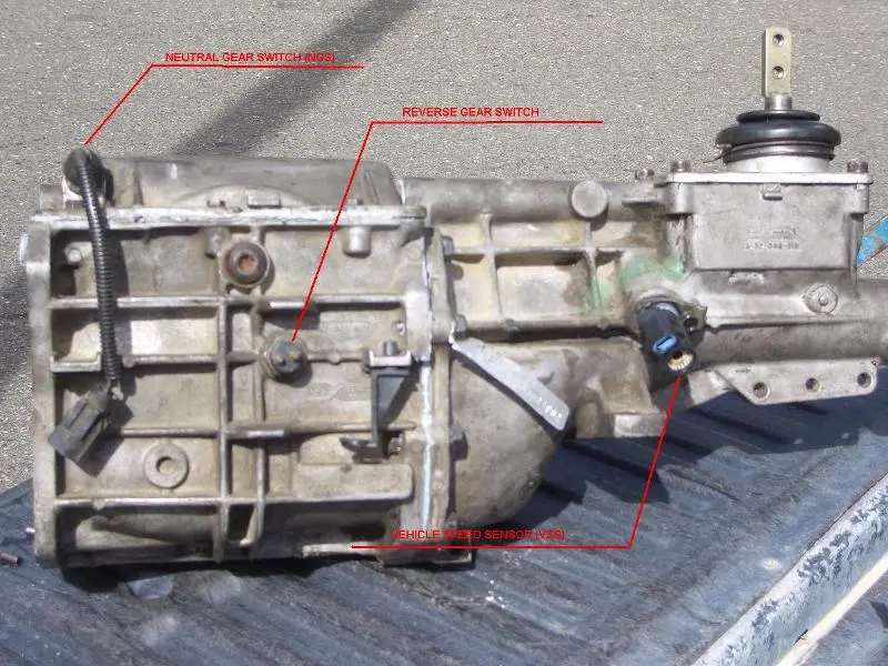

No you are wrong the neutral safety switch does not allow this, the clutch pedal (ie clutch switch) still needs to be depressed to start. The neutral safety switch goes back to the computer and let's the car know if you are driving so it bumps up the RPM a touch, as does the vehicle speed sensor (both do the same thing). So if you put the car in gear, or start moving either has the same effect. So if it's faulty when you let out the clutch the ECU thinks your now driving so it bumps up the RPM. Shorting just tells the computer you are always in neutral.. until you start moving then it picks up the VSS and no difference driving.

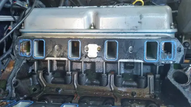

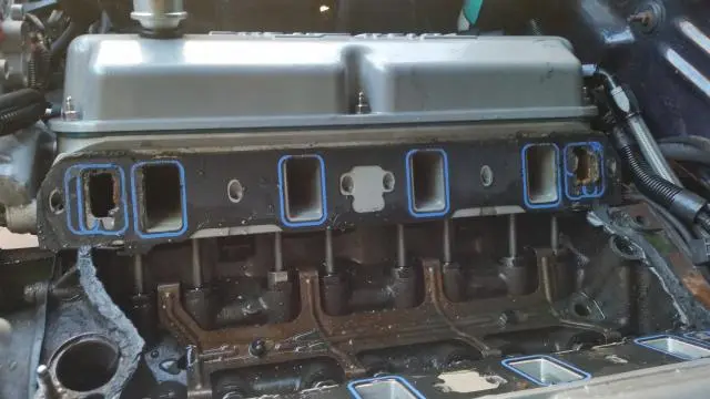

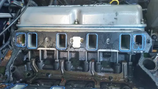

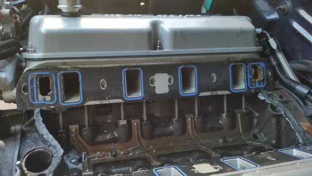

I bypassed both of them. I replaced the clutch switch and then replugged it. I have no idea what else it can be. I just removed the lower intake and the gaskets looked perfect. Here are pics.

Ok, I replaced the gaskets, reinstalled everything and the problem still occurs. I disconnected the clutch switch again temporarily. I installed a fuse in the plug and bypassed it. I installed and removed the fuse several times the idle drops every time I install the fuse. So a bad switch is out of the question. The car idles great but I can feel the difference without the switch connected. The idle hangs a bit and tends to buck a bit at low speeds in gear.

Yah man I agree here, it still sounds like the neutral gear switch. So please just clarify one last time, you went under the car, disconnected the wires going to the neutral gear switch at the front/driver side of the tranny, and shorted them together, and this had no effect ?

Yes.. like I said right from the very start !! It IS your neutral gear switch (sometimes called 'neutral safety switch' - same thing), that describes the symptoms you are having to a T. It plugs into the front drivers side of the tranny, near the top. You can't replace it without pulling the tranny, but you can undo the connecter, and 'short' together the wires that go back to the computer and it should solve your issue.
