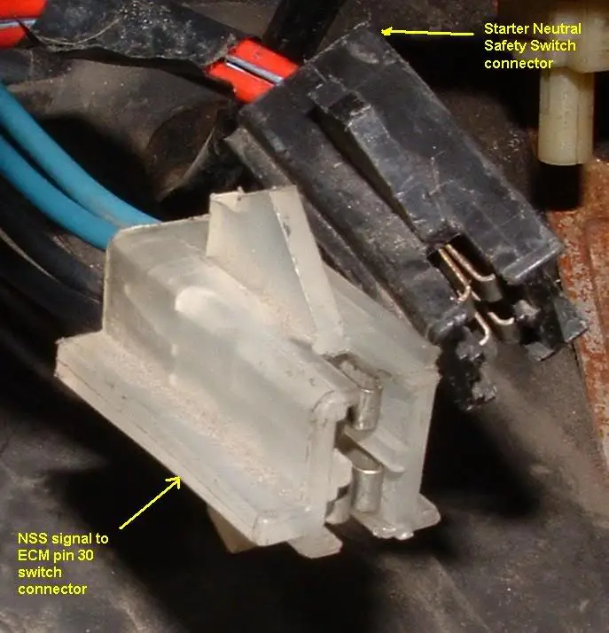

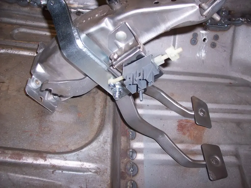

On the clutch pedal box under the dash, you'll see a small gray switch. Looks like this
Plugged into it, you'll see a black plug with red wires, and a "clear" plug. The black plug is the starter circuit. Leave it plugged in. Take the clear plug off, and stuck a fuse to jump it out. Drive around for a bit and see if makes a difference.

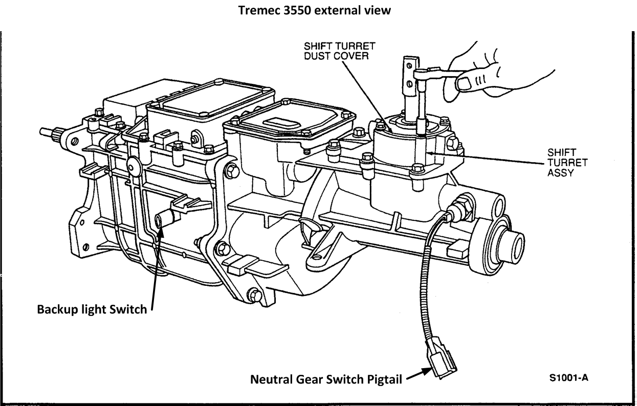

@pearlnotchback
@Mustang5L5
I have a 3550 in my Mustang and it does have a NGS switch - see the drawing below
