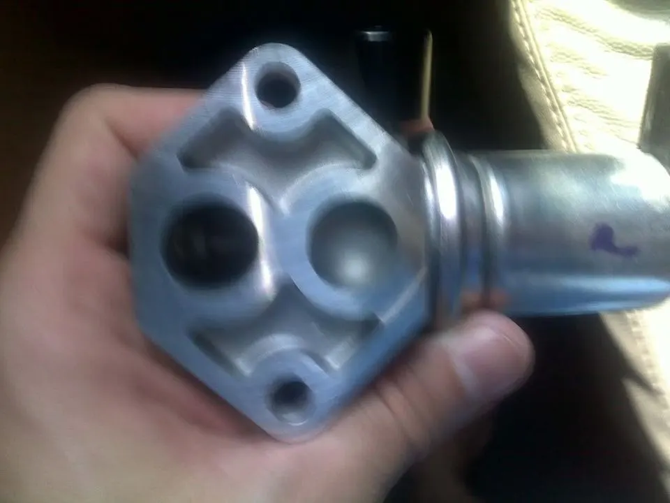

Hi,

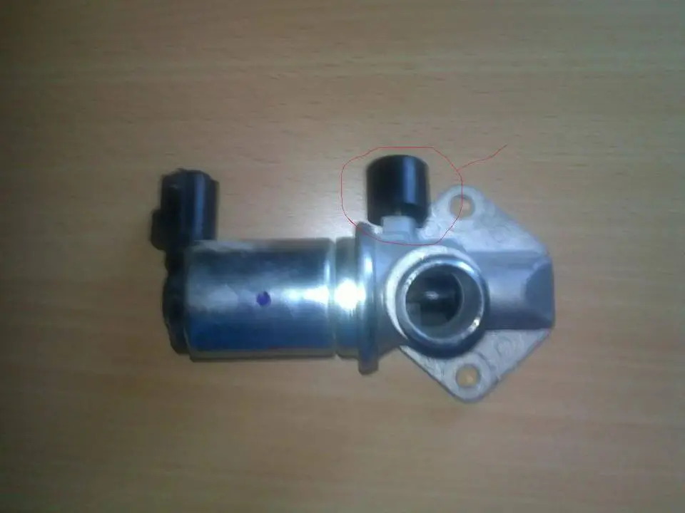

My 99 GT stalls when i come to a stop and it idles bad sometimes. When i'm at a stop and hit the gas a bit the rpm will go down to about 500 and car wants to stall. And sometimes does. I thought it might be from the IAC, so i pulled it and turns out it is new because previous owner had replaced it a few weeks ago. There is a black knob on top of the IAC which i didnt know what its for. Could that be the problem? that i need to adjust that?
See pics below
Note how clean it is :
Any thoughts ?

The black knob on the IAC is a vent. It is used to allow air to start the motor.

OBTW, A big cam can lower engine vacuum. The black vent on the IAC needs a pressure differental in order to close. If not enough pressure differential, the vent may open and allow unmetered air. The unmetered air causes the MAF to under state the air and the motor goes LEAN.
However, this is almost surely a tune issue needing an updated load table.

The black knob on the IAC can be turned right and left, and i didnt really know what to do with it, because my 2004 GT didnt have that knob, so i just left it like that because it didnt really matter which way i turned it. I do have a Diablo hand held tuner, so i would need to get a mail order tune. Does anyone know where i can get a mail order tune? I asked Diablo but they dont do mail order, so!!?
The black knob is not an adjstment. Turning it does nothing.
