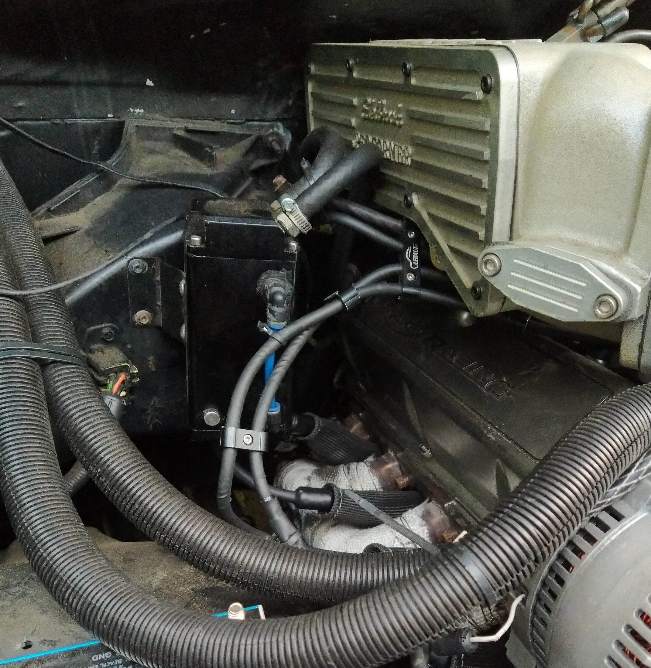

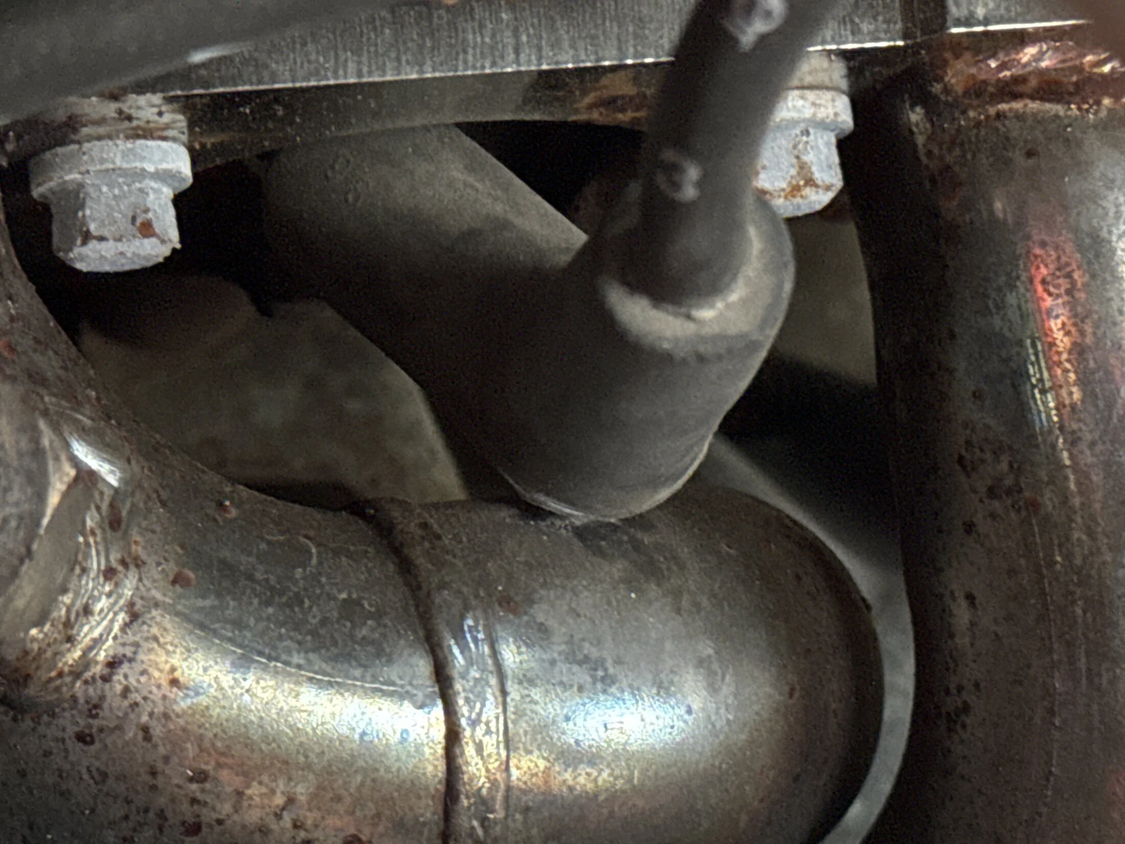

I’ve got a 94 with 38k miles. Occasionally it will stall at idle. Could a spark plug wire rubbing the header cause it to die? Or should I keep tracing down the issue? I did see the idle surging checklist and will follow that but the first thing I saw when getting started on the checklist is the plug wire rubbing the header. Pic attached.

Running on less than 8cylinders could cause idle/stall issues, fix that wire, and any others looking suspect, I'd check the plugs too if they been there a while.

Thank you. Also wanted to note that when it dies it does start right back and I’m able to drive away and the idle is fine by the time I come to a complete stop again. It’s seems very intermittent

It might sound innocent but its pretty harsh on the coil and also the 02 sensor in many ways as the spark gets bypassed by the copper resistor sparkplug so if running anything but resistor plugs isnt recommended although others will say otherwise I use nothing but #24Autolites and #24R Autolites in ford engines w/ stock heads & exhaust manifolds and Autolite #255 shorty headder plugs for engines with headders
To give your 02 sensors a more honest reading you should wrap your headders and also put boot protectors on the ends of the wires..
The spark thats hitting the headder is being sensed by the O2 sensor ground on the sensor & pin #49 and the misfire is messing with the ECU in the form of alot of noise in the circuits..When the system gets way too noisy it shuts down...........
When you look at my wires I layer them in EMI resistant shrink wrap too........

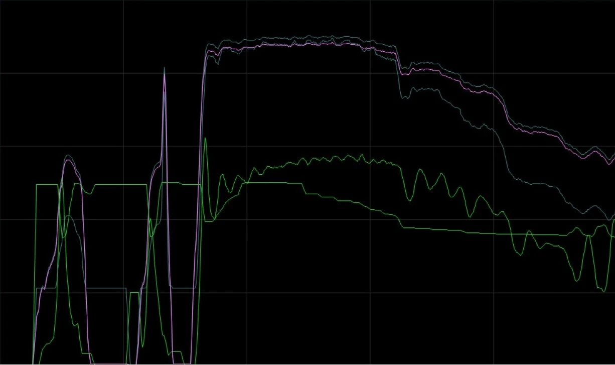

This was before I changed the settings plus I did the recommended base idle reset...It made my car sound like it was tuned on alcohol and had a radical camshaft meanwhile all I did was change the maf , and throttlebody plus changed out the 1.6 rocker arms to 1.7's..................

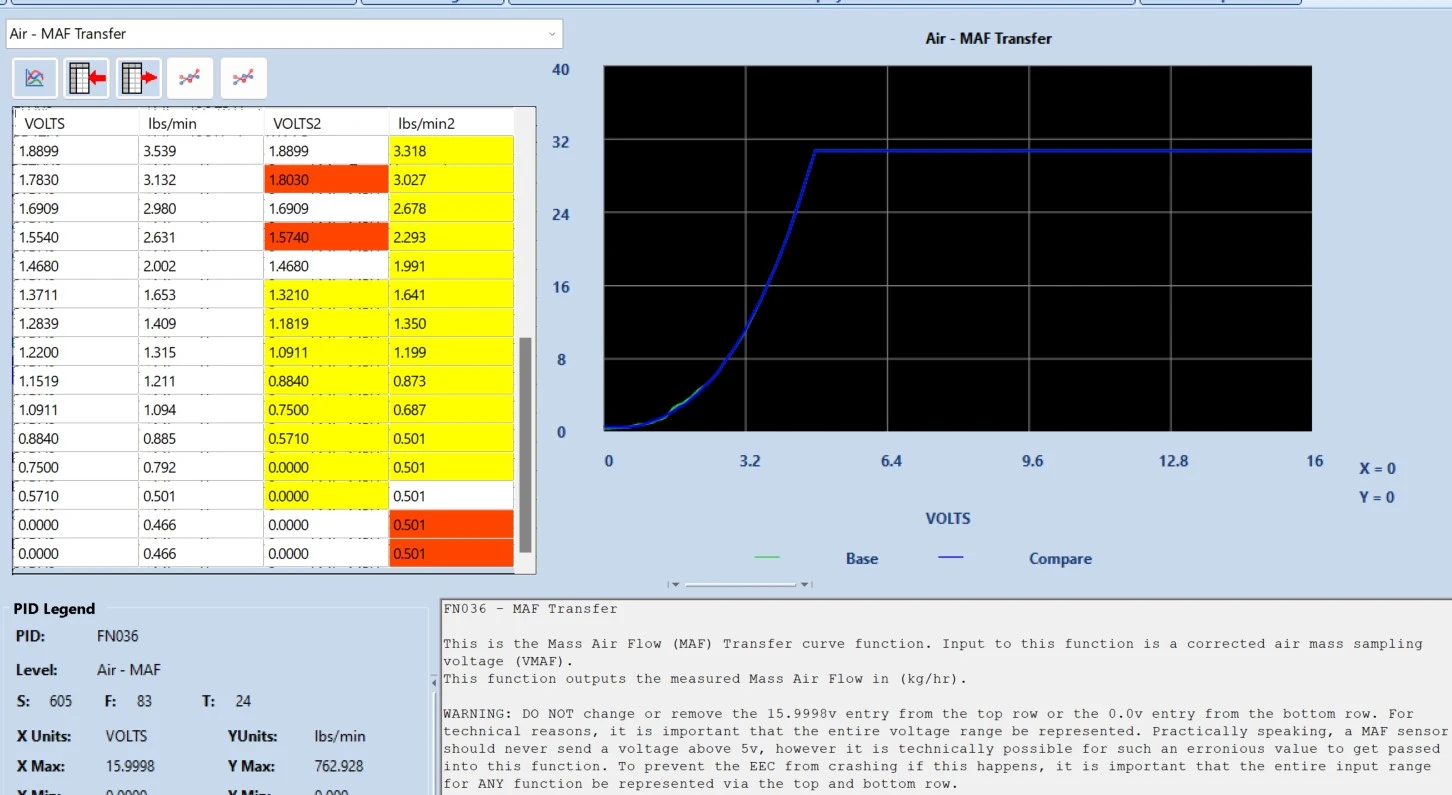

The 3 near the top are the MAF settings and the two greens in the middle are idle and IAC.

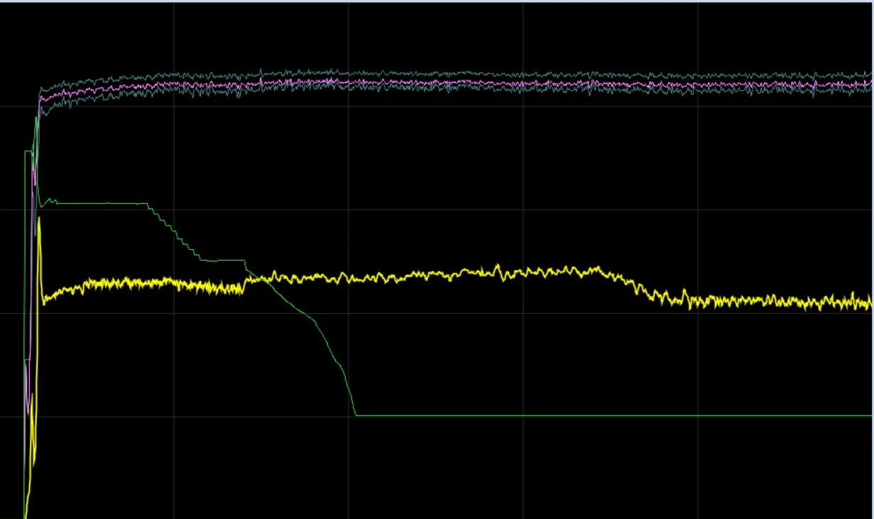

The choppy green is the idle and as you can see the IAC was so slow it didnt have time to correct so when you have a system in chaos its not good to add to the chaos already going on............
This is after finetuning the MAF transfer plus the IAC settings , spark settings and increasing the lowslope setting 15% for the fuel injectors giving them better control at idle ;-........This is what I got after a base idle reset setting the idle only 75rpm's under target rpm................
Th 3 top ones are the MAF and you see the grouping is almost dead on yellow is the idle , green is the IAC just doing what its supposed to do and the scrambled lines representing a radical camshaft are gone......

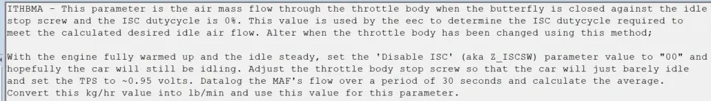

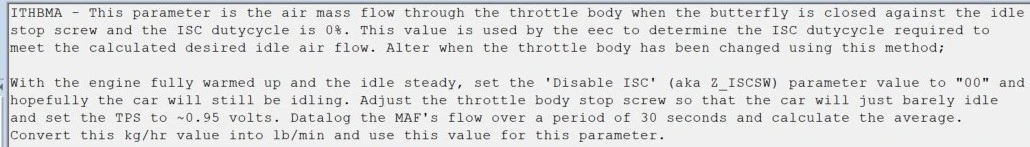

Its quite evident of the one size fits all when looking at the throttlebody setting where Ford uses 0.550 lbs/min for all throttle bodies regardless of make and model and engine size...

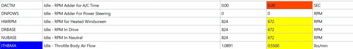

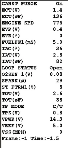

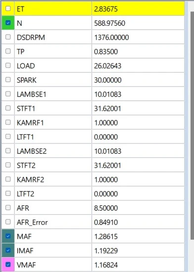

Heres what my stock 302 pulled on air at under 600 rpm's of idle setting and what the MAF is pulling and creating a certain voltage
When you look above and look next to the current settings are the stock generic A9L settings that cause that huge idle swing and when you look below notice the flow rate flowing through the meter.. After doing the math and calculating how much flow is being used by the IAC at 14% the number gets deducted to become the 1.0891 regardless of what it says above as the engine will run pig rich....
The voltage determines flow rate of the fuel to be sprayed...........At 588rpm's this engine was pulling 1.28615 lbs/min of air. Stock idle is 672rpm's and ECU is set to 0.550.........LOL
Heres what my MAF transfer looks like compared to a stock A9L computer setting....It only takes very small incriments of .002 at a time to change fuel rate of the injectors

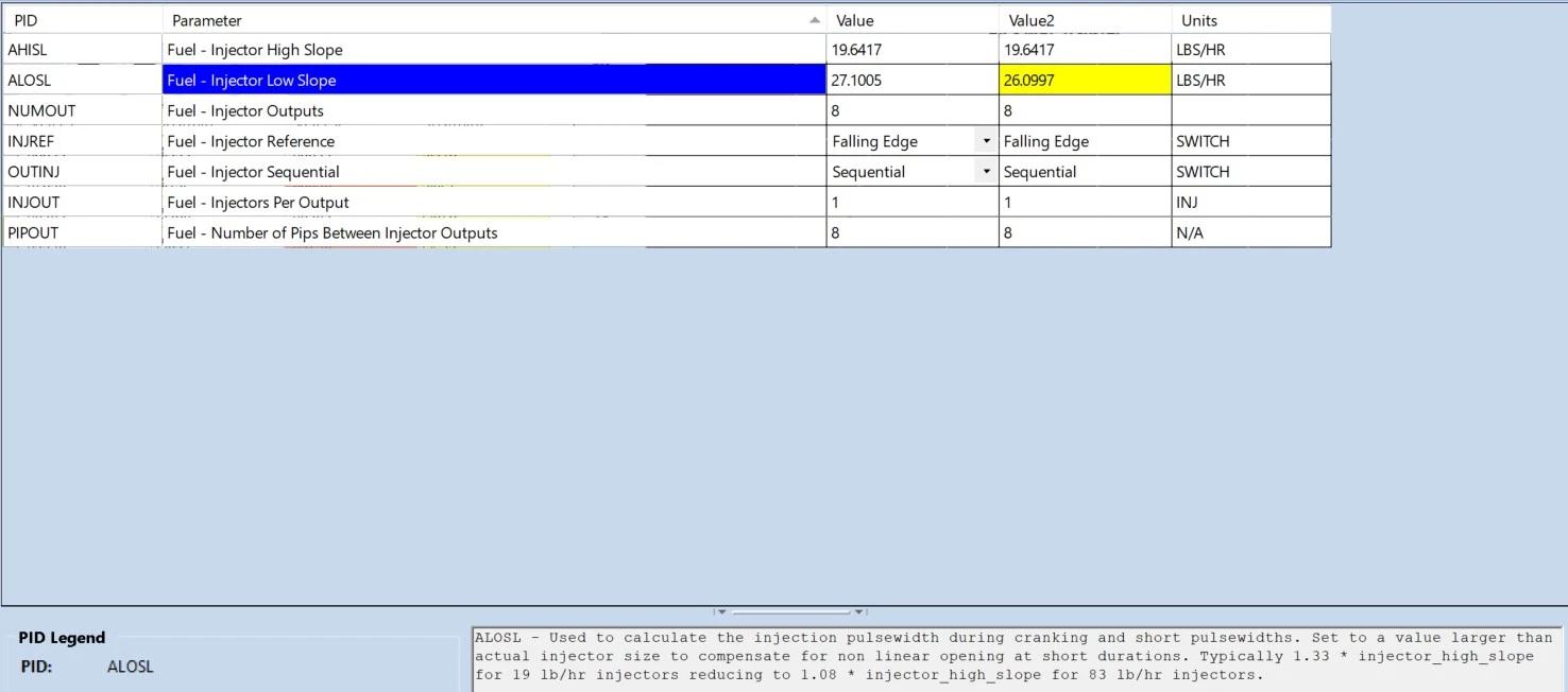

This is stock lowslope fuel setting on the right compared to mine...........When you raise the number the duty cycle lowers and fuel at idle becomes way more manageable too...........
When you go by Fords recommendations it seems that the real math doesnt reflect the lowslope setting it should be....19.6417 x 1.33 is 26.123461....

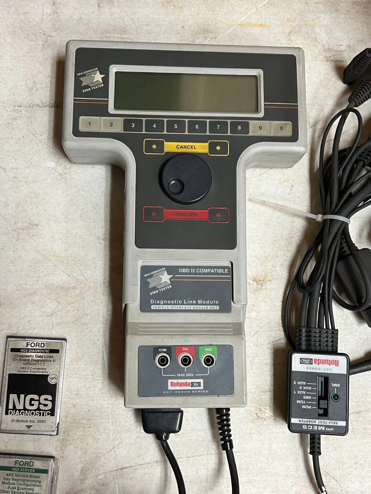

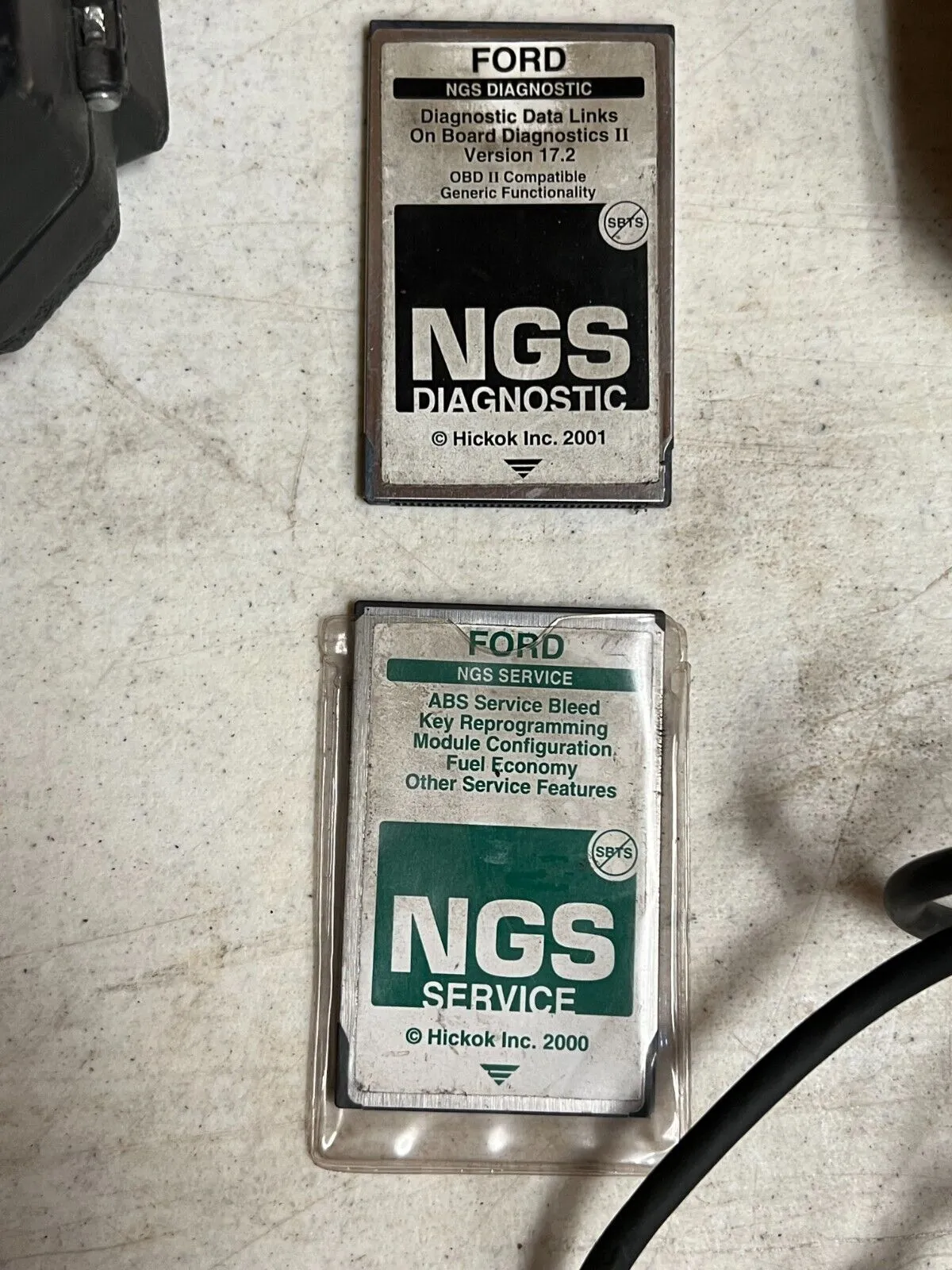

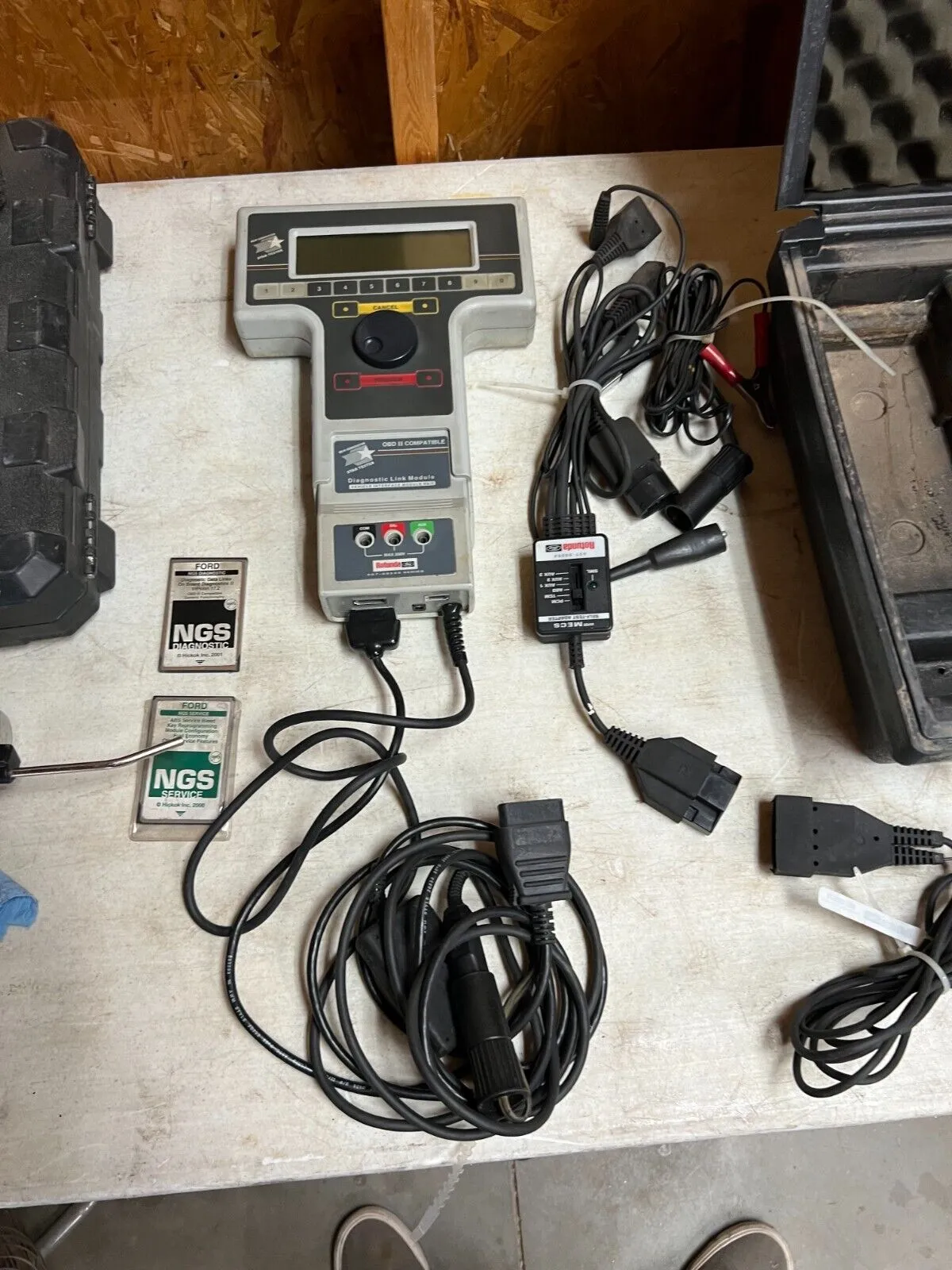

What lots of people dont know is that one of the services a local Ford dealership was capable of doing for a fee under special requests was finetuning your vehicle to the altitude and MAF flow plus the other settings by actually changing the same settings I did with a tool that looks like this....
Most people would never know until aftter changing out the ECU and having the car run differently and if you dont know to tell the rebuilder youll never get the same parameters back either(food for thought)......LOL

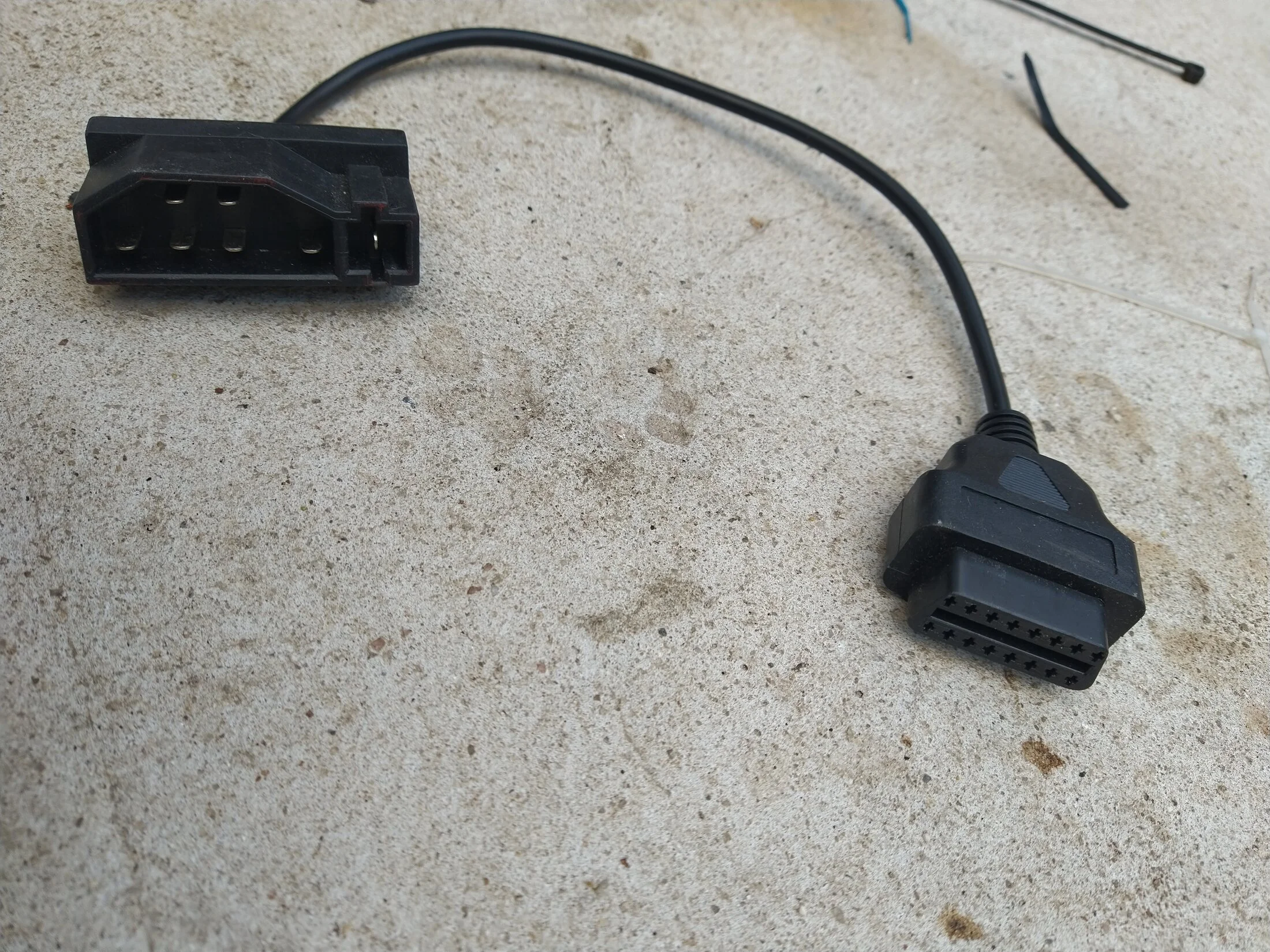

For desert you should also know that with a special $10 adapter you can convert OBD1 into OBD2 and read whats going on with a scanner able to read both you can read live PID's for certain parameters as the engine is running............
